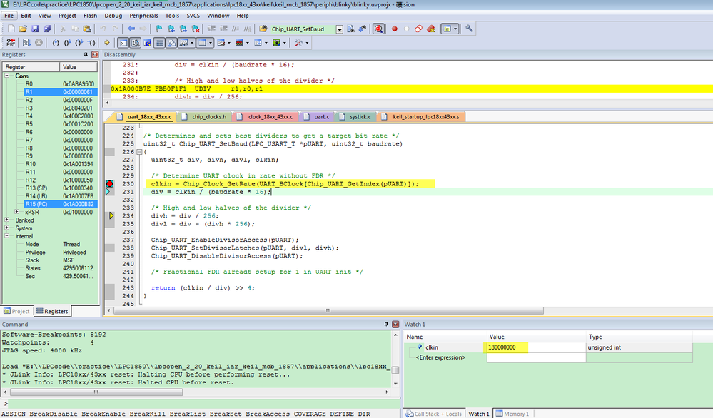

 Let me know about the the PCLK value at which the UART of LPc1857 is working? I am using Keil MDK5. Is there any window available during debugging to know the available clocks like PCLK and their values loaded? How we can know the activated Baud rate corresponding to the DLL and DLM loaded by us in MDK5?
4,263件の閲覧回数
kerryzhou
Hi NELVI JOHN,
   Please check this MDK IDE debug result:
Kerry

    I have configured clock to USART3 by software. the code is as below:
void SCI_PortClock (uint32_t clock) {   if (clock) {     LPC_CCU1->CLK_M3_UART1_CFG |= 3;     while (!(LPC_CCU1->CLK_M3_UART1_STAT & 1));   }   else {     LPC_CCU1->CLK_M3_UART1_CFG   &= ~(3);     while (LPC_CCU1->CLK_M3_UART1_STAT & 1);   } }
I haven't configured PCLK separately. So, is it there is any fault in being the conclusion that the PCLK is default 12MHz.

kerryzhou
Hi NELVI JOHN,
    If you don't configure it, just enable the UART3 clock to RUN, yes, the default clock is IRC12MHZ.
