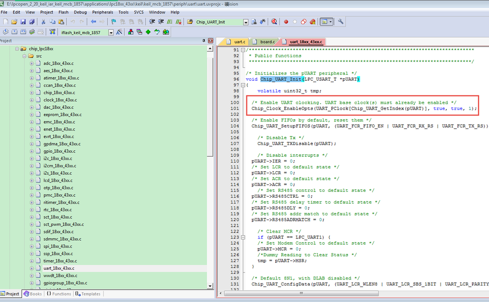

    Please download the MCB1857 lpcopen code from this link:
http://www.nxp.com/assets/downloads/data/en/software/lpcopen_2_20_keil_iar_keil_mcb_1857.zip
  Then open periph_examples in folder:lpcopen_2_20_keil_iar_keil_mcb_1857\applications\lpc18xx_43xx\keil\keil_mcb_1857
  You will can find the uart initialization code in uart_18xx_43xx.c.
   About the clock, you can debug it to get it, this is also one way to learn it.

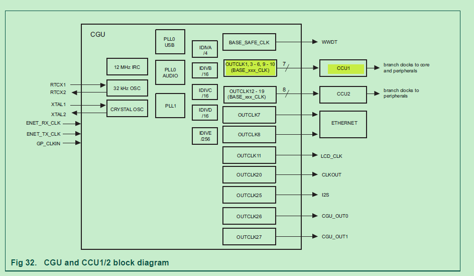

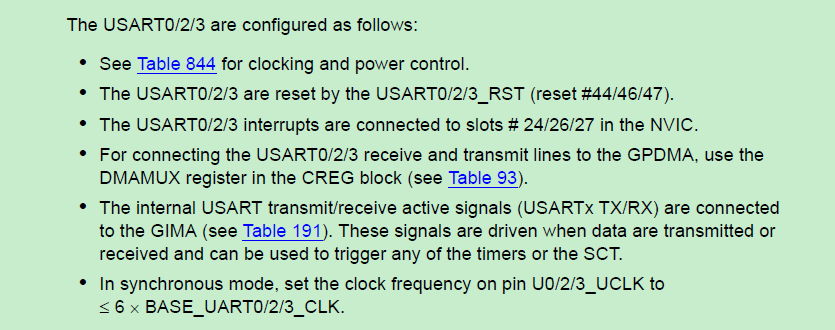

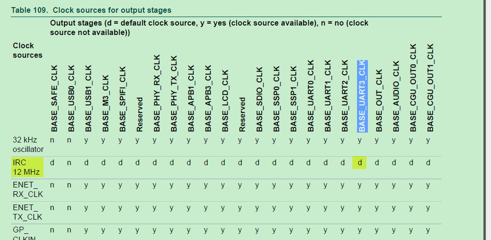

Hi NELVI JOHN,
    If you don't configure it, just enable the UART3 clock to RUN, yes, the default clock is IRC12MHZ.
   You can find it from these pictures:
Wish it helps you!
