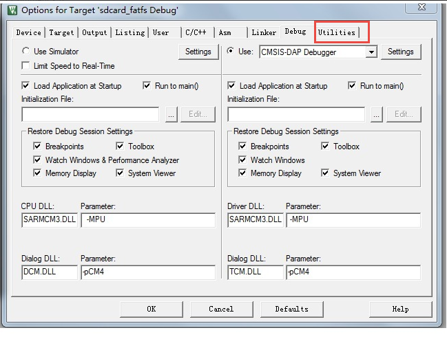

I am trying to build and download sdcard_fatfs demo code, could pass build, but fail to flash download in Keil enviroment, following are the errors, appreciate any comments.
I attached my debug configuration picture.
Load "debug\\sdcard_fatfs.out"

   Please also check the MDK configrations:
  Whether in Utilities also have he debugger configurations?

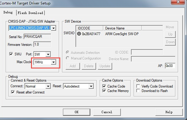

  In this picture:
Please select the lower max clock and try again.
  If you still have problem, please tell me the board, the code and the MDK version which you are using, then I will try it on my side.
