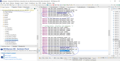

My first question is whether there's a problem with setting both the bulk in and bulk out endpoints for the MSC interface to the same endpoint number - that's how the CDC DIC endpoints are set up. In the examples, bulk in is EP 1 and bulk out is EP 2. I've set them both to EP 1 and it seems to work, but I'd like to understand what's going on and if there was a reason they were set differently.

Pls refer to the USB device example dev_composite_cdc_msc_disk_bm, in the usb_device_descriptor.h, you can see that MSC class requires two endpoints, the CDC requires 3 endpoints, 2 data endpoints and one communication input endpoint. In other words, the MSC+CDC requires 5 endpoints.
The USB1 of LPC55S69 has 12 physical (6 logical) endpoints, so it is enough.
For the MSC class, bulk in is EP 1 and bulk out is EP 2. Because the EP index is the logic endpoint index, one can only function as INPUT, another can only function as output, so you can set them both to EP 1.
