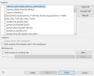

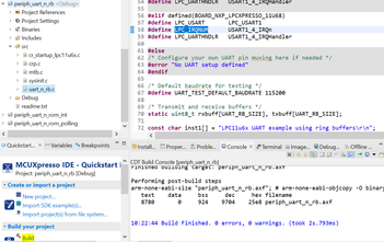

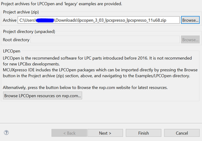

If you are using MCUXpresso IDE, please follow the next steps for use and build the examples:
  • After downloading the .zip file, open your IDE, and go to Import project(s) from file system…
  • Browse the .zip file you download it, then click Next
  • Check the box of the examples you want to test, and check too the lpc_board_nxp_lpcxpresso_11u68 and lpc_chip_11u6x. These two contains files needed for the example to build correctly. Finally, we click on Finish.
  • Select the project you want to build, and try it out:
Related at your code, it seems the configuration is good, nevertheless just for double check, please verify you setup/initialize the UART clock, and your pins for the USART1.
