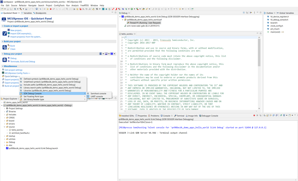

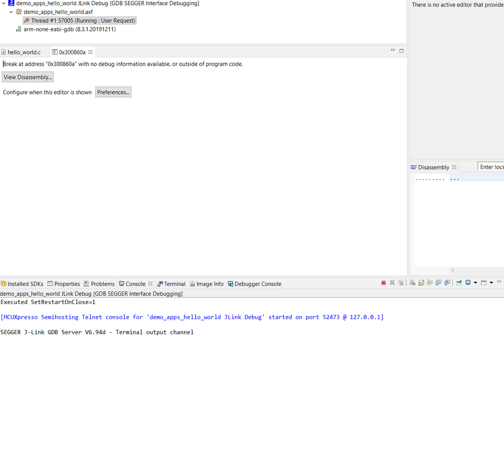

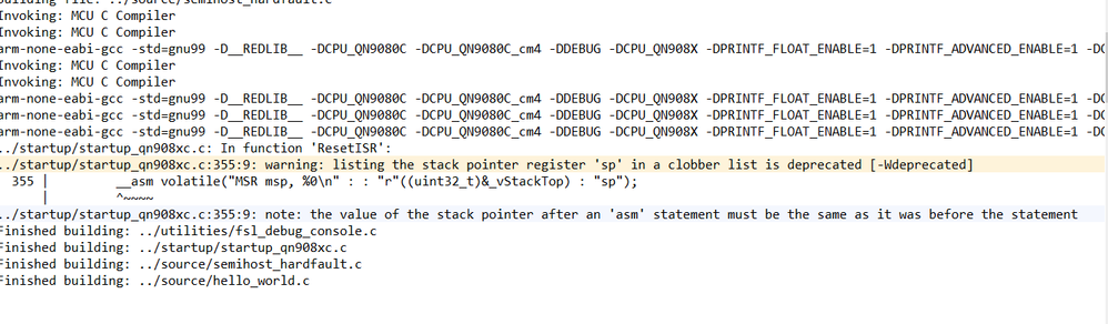

Here is an example of where my IDE or my set up is going wrong. Here is the hello world example.
When I build, the start up thing has a warning of clobber list is being deprecated. Then, when i go to debug, the menu shows up with no probes found. Then the debug program keeps running and will not set a breakpoint.deprecated.pngno probes found.pngdebug.png

stephanie_m
I believe that you are using semihosting in your examples, if that is the case, you will need to change it to use the UART instead of the semihosting; due to time restrictions the wireless connectivity examples need to use the UART interface instead of semihosting to be compliant with the wireless protocols timings .

andrew_ha

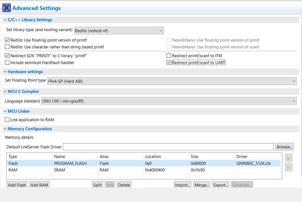

Ah i see. As a follow up question, do i need to redirect the printf to uart as well? Thank you so much for your help.uart question.png
12,771 Views

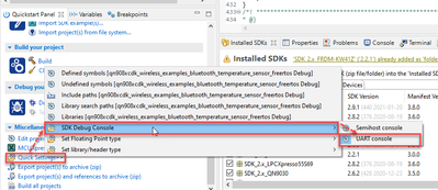

stephanie_m
You will need to select the project and modify in the quick setting the following

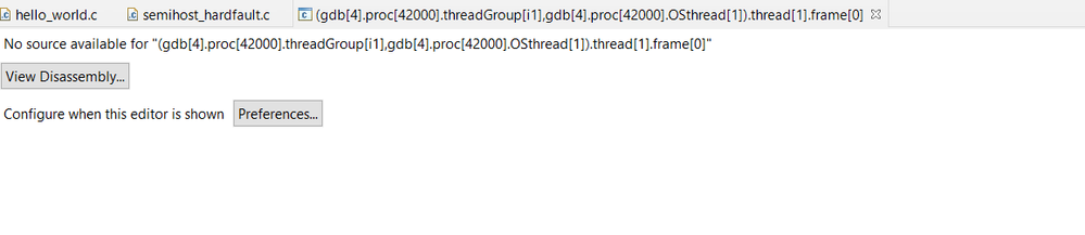

andrew_ha
Thank you, but it still would not debug properly. Perhaps there is a bigger issue to this.Screenshot 2021-02-26 151819.png

andrew_ha
Yes thank you. For the ble dongle problem, I will address that issue with connectivity tool. The main issue was running the program and the debugger not working properly, so i tried to use a simpler example of hello world and realized i was now having trouble with hello world.
I posted a separate question for hello world, and once that problem is fixed, i will work on the ble dongle issue.

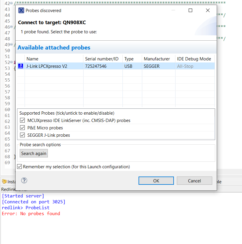

andrew_ha
Before I try solving the dongle issue, could you maybe look at my IDE issue. When I try to debug, it has trouble finding my board I think. This pops up when i press debug.
Hello world does not use the dongle so i want to show you this first.
12,811 Views
converse
Senior Contributor V
This window is normally shown if your application has taken an invalid jump 'into the weeds'. Look at the register window and the PC to find the address. Maybe you have not setup the vector table correctly?
