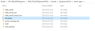

Hi, Doug,
I think the default example code for the LPC55S16-EVK board is the LED_Blinky project in SDK package as following Fig
Pls check.

Thanks for the suggestion, and I agree the LED_Blinky project ought to be the LPC55S16-EVK "as delivered" firmware.  The "as delivered" firmware, however, configures three board buttons to display different LED colors.  A static reading of the LED_Blinky project seems to show it only configures a single button for LED control so that doesn't appear to be the "as delivered" firmware.
I would like, after I'm done with the board, to return it to original condition for the benefit of the next user, so finding the original firmware would be desirable but of course not essential.
