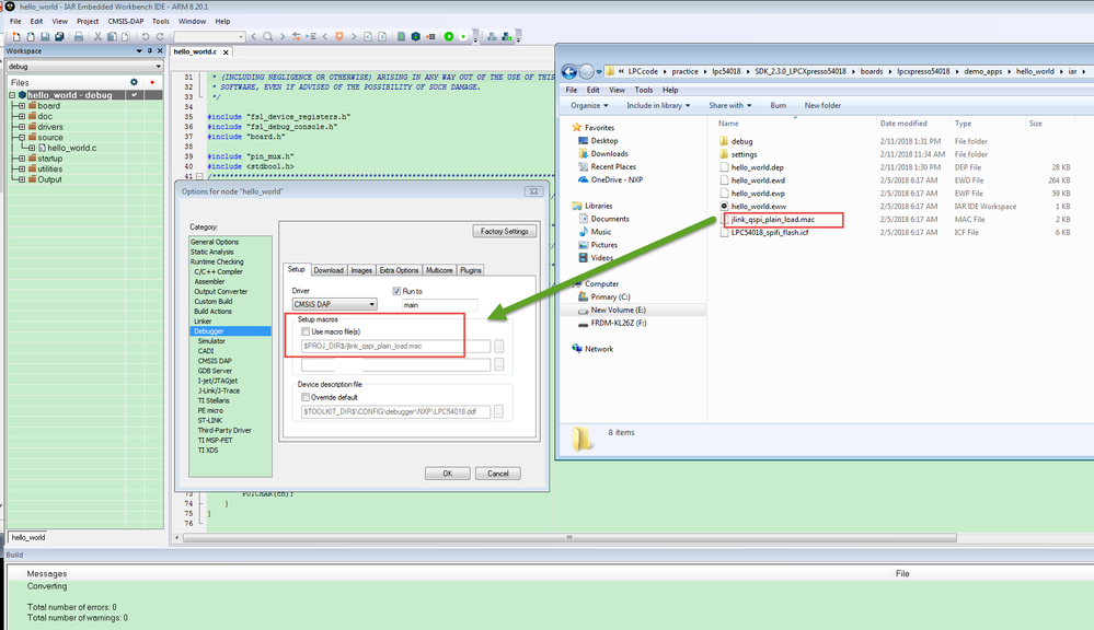

kerryzhou
Hi Vivek,
   Please also check your project mac file.
   From your error log, your problem is caused by the macro file:
Please use the SDK project attached mac file, like the following picture, you can select the setup macros:
Wish it helps you!
Kerry
