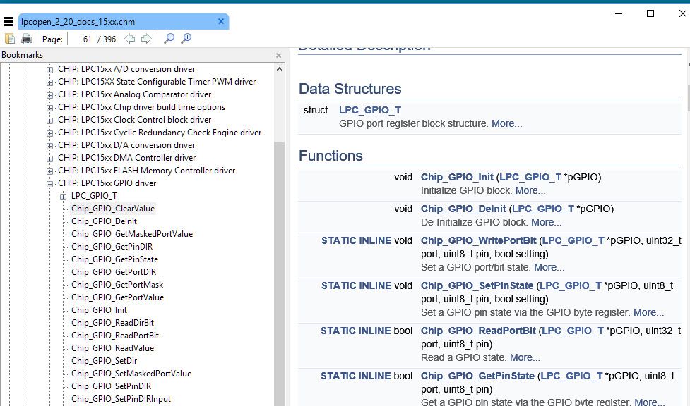

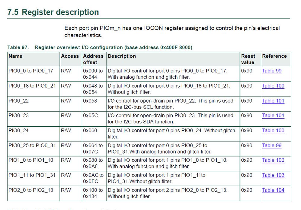

I'm trying to reconcile the info shown in the LPC15xx User Manual (UM10736) and the info given in the lpcopen_2_2_docs_15xx.chm file.
This .chm has super details about the LPCOpen 2.2 lib which one would need - but the names of thefunctions, registers, etc don't line with the users guide PDF. I've spend several days trying to find this out, and have basically given up and now looking at ST Arms as they provide far better docs.   I'm inclosing 2 pix - one from UM10736.PDF and one snaphot from the .chm file that nxp supplies. As you can see it is pretty tricky to get a direct correlation between the two.

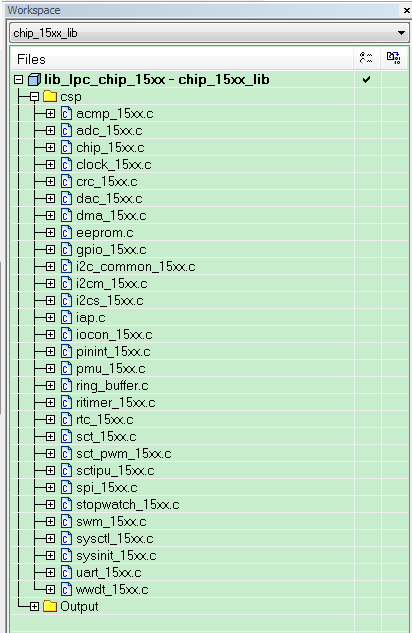

Hi Alan Reinhart,
In the lib_lpc_chip_15xx project, the set of xxxx_15xx.c illustrates the way of configure the peripheral registers.
Please refer to it for details.
Hope it helps.
