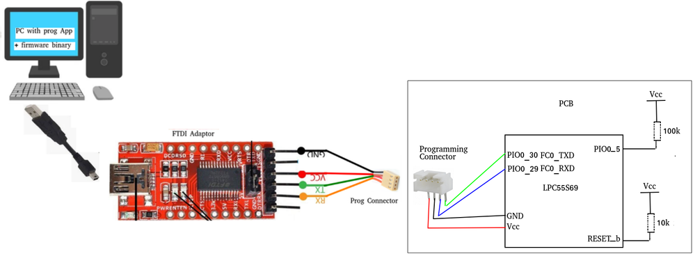

I am working on LPC55S69 and need to flash firmware (.bin/.axf etc) via USB-to-Serial (FTDI) cable, the programming connector
I need to design new firmware for a device having LPC55S69, the existing device has a programming connector and a programming cable as given below,
As far as I know to program LPC MCUs we can use ISP Boot mode with Flash Magic, but for that I need to use two more pins of the MCU i.e., ISP and RST, so in total 5 pins (Vcc, Gnd, Rx, Tx, ISP and RST), the ISP and RST of MCU connected to RTS and DTR of the FTDI adaptor (or activate the ISP and RST pins of MCU manually by shorting them to GND)
So I need to know is there “ANY WAY” by which we can program LPC MCUs by only Rx, TX (and Vcc, Gnd), without using ISP and RST pins of MCU (or by connecting ISP and RST internally to some thing which is triggering ISP boot mode).
Or if they have written their own bootloader that can be used without using ISP and RST pins of MCU.

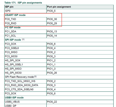

This is the uart pin, you have to use uart0 to transfer application code.
You can use blhost.exe on PC side to download code via uart.

Great thanks for your reply XiangJun Rong sir, actually as I mentioned earlier as far as I know you can activate the ISP and RST pins of MCU manually by using button or a jumper, RC circuit etc, so that the LPC55S69 enter ISP mode, then we can use the FTDI to transfer application code.
What I observed in the PCB the PIO0_5 (ISP pin), RESET_b pin are left floating and in the drawing a pull-up resistor is shown but no button or jumper is there.
As you can see the Reset or ISP pins of MCU are not controllable (by a button etc) by the user, we are just plugging the FTDI to the PCB and able to flash the firmware.
May be they have written their own bootloader and custom PC app to flash the MCU.
Please help me is there “ANY WAY” by which we can program LPC MCUs by only Rx, TX (and Vcc, Gnd), without using ISP and RST pins

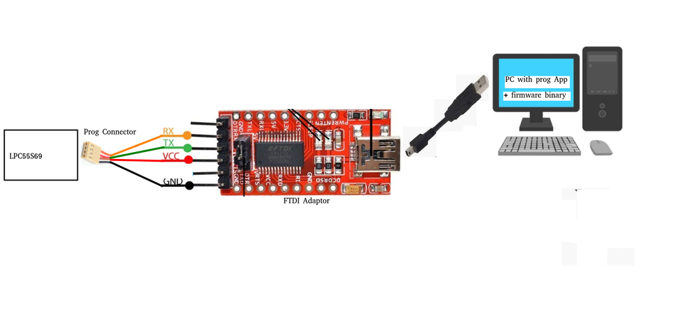

Yes, the following connection is correct.
The FTDI module is enumerated as a USB device with a COM port when the usb of FTDI is inserted to PC.
You can use the blhost to communicate with the LPC55S69 using the COM port.
For your question, you have to provide power for the LPC55S69 so that the LPC55S69 can work.
If you use LPC55S69, I suggest you order LPC55S59-EVK board and have a test.

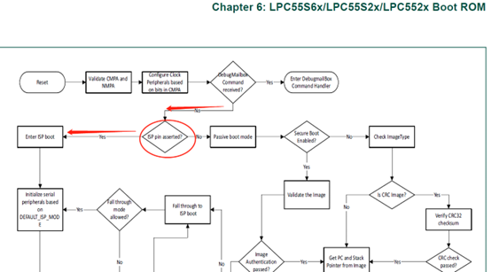

ZhangJennie
Hi aashish1 ,
To enter ISP programming mode, the ISP pin must be inserted. Please refer to the following boot sequence chart, which is extracted from the UM.
Hope this helps,
Jun Zhang
