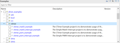

I am using an LPC54606.
For now we have solved it  managing two fans with the same pwm output. Are there any examples of PWM management with Ctimer instead of SCTimer? They might be useful to me.
Best Regards
1,516件の閲覧回数
Omar_Anguiano
Thank you for letting me know your part number.
The SCTimer of the LPC546xx family is limited to 10 events.
We have PWM examples with the CTimer at the SDK, I suggest you use it as a reference.
If you have more questions do not hesitate to ask me.
