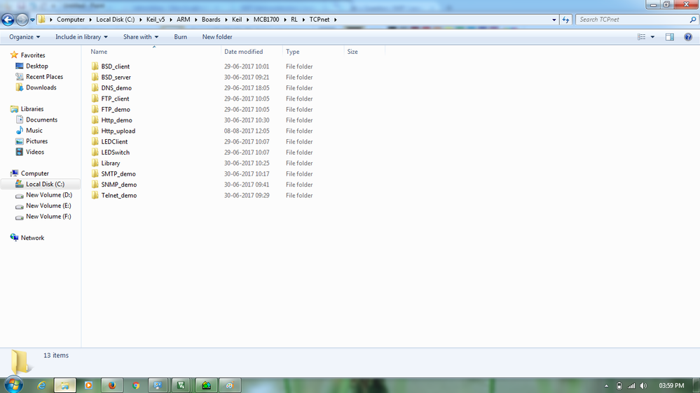

       I'm using lpc1768 controller. When i use "easyweb" demo application stack with my board it can respond ping queries and using web page for a default web browser also works fine.
      But when using TCPnet demo applications which was given by keil my board was not respond with ping queries. I tried all demo applications but it didn't work. I attached a screenshot for root path to access the demo application.lpc1768 TCPnet.png
Please help me to solve this issue.

  I getting solved my problem. The cause was i forget to disable dhcp which was enabled in that stack.
  After disabled dhcp my board works fine.
