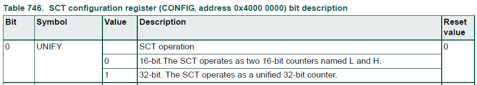

I am using a LPC4357 microcontroller and I am trying to decode a PWM input signal using the PWM peripherals on the chip. What I want to do comes down to this: I want to use 2 (out of the 3 available) counters to count the high and low time of my PWM signal. With that information, I can deduct the duty cycle and frequency of the signal, which is the information I need for my application to work.
However, from the manual (UM10503) I cannot really tell if what I want is possible. First I was thinking I could create capture events on the falling and rising edges so that the counter values (the high and low times respectively) are written to their capture registers and I can just poll those anytime if I want to read out my PWM signal. Now, my problem is that I can't find a way to have the counters start at the right time. From the manual I see that I can start the counters/timers/TC by writing a bit to the control register, but I want the counters to start counting only when my signal has a falling or rising edge. There is an option to have the counter advance whenever a falling/rising edge is detected, but I don't want the counter to just increase by 1 when that happens, I want it to keep counting using the base/peripheral clock. Is what I want possible? I feel like it should, otherwise having PWM input would be pretty useless.

jeremyzhou
Hi Jan Maarten Buis,
It's possible to implement it, SCT is able to be triggered upon detecting the rise or fall edge.
You can learn the more information in Chapter 31: LPC43xx/LPC43Sxx State Configurable Timer
(SCT) with dither engine in the RM.

jeremyzhou
Thanks for your reply.
As I know, the SCT not only operates as two 16-bit counters named L and H but also operates as a unified 32-bit counter.
So I consider it's able to implement application as you want to.
