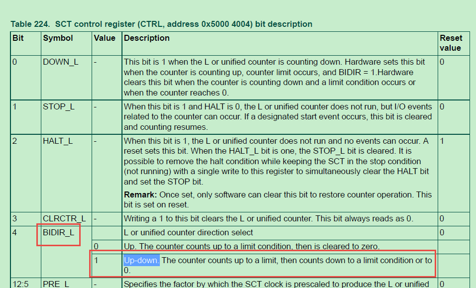

In attached sample code can you help me how to configure PWM in center aligned mode?

    Do you just want to configure the counter to up-down mode?
    If yes, please modify the  SCT control register, BIDIR_L and BIDIR_H to 1.
  Just like the user manual, SCT regiser description:
Please try it on your side.
Wish it helps you!
If you still have question, please let me know!

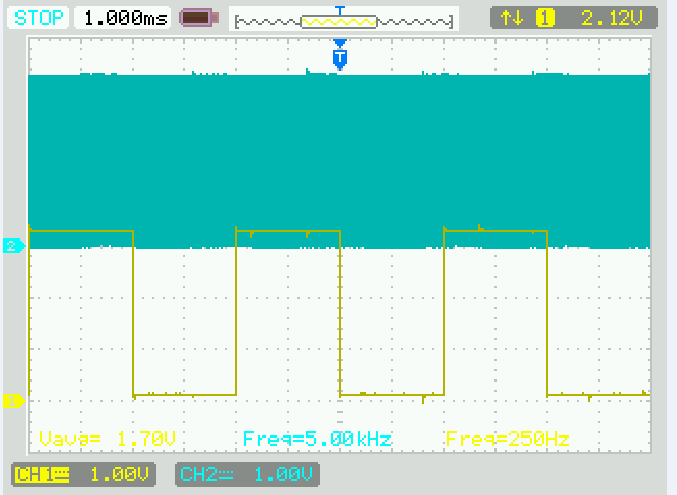

   I don't know why you said configure BIDIR_L and BIDIR_H to 1 unable to work?
  I just modify these two bits, it works on my side.
  As you know, CPWM will make the counter to up-down, so the frequency will half of the original counter up.
  This is my test result and code is in the attachment.
This project will generate 250hz at PIO0_16, 50khz PWM at PIO0_12.
Wish it helps you!
Kerry
