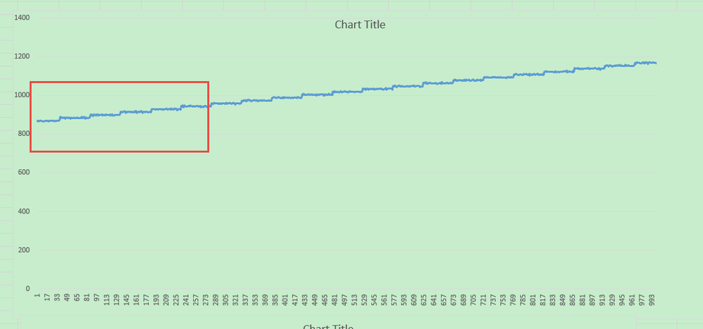

I'm using the LPC11U68, and am seeing rather bad ADC performance.  If I run a precision ramp into the input to collect the transfer function, I see that it plateaus at 8 counts before every 64 count boundary, and then jumps up to the boundary.  So for example, the ramp will be clean and one to one from 0 to 56, and then the ADC continues to return 56 for 8 steps, and then jumps to 64.  Same thing happens at 120 through 128, 184 through 192, etc.
This has been the case with multiple samples of the chip.
Has anyone encountered this?  Any ideas?  I am running the chip at 3.3V, Ref at 2.5V, and doing the ADC calibration operation per the user manual.

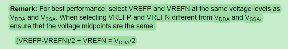

First, we set up our firmware and our ramp generator on your Xpresso eval board.  With this configuration we found that the 8 count jumps *did not* occur.  The data looked fine.  This lead me to consider what the differences were between your eval board and our board.  At first I thought that maybe it was the source impedance of our VREF supply.  But in fact, that is not the problem.  I am pretty sure now that the ADC performance issue is caused by the VREF being 2.5V.  If I supply our board with a 3.3V VREF, through 100 ohms with a 10uF filter, the ADC performance is fine.  If I change the VREF to 2.5V, with the same circuit configuration, the 8 count jumps are present.
We consider this performance to be very bad.  It is true that the User Guide mentions that for best performance VREF should be the same as VDDA.  But 8 missing counts is very poor performance indeed.  And if a user wants an accurate voltage reference, it *has* to be lower than the available power supply voltage that is used to generate the reference!  The datasheet gives no performance data at all for this common configuration.  If we had been able to find out that with a 2.5V reference the ADC becomes effectively a 9 bit converter, we would have known that it would not work for our application....
Please try your test setup with a 2.5V reference and see what results you get.  You will need, however, a quieter signal than what you showed in your previous postings.  I would suggest that you divide the output of your signal generator by e.g. a factor of 10, and add a filter capacitor right at the ADC input.  That way you should be able to get a quiet enough signal.  You should see the jumps at every n*64 count boundary, so you only need to sweep say 100mV of the input range to see one.

   What 2.5V you are using? Did you test your 2.5V, is it stable? Please use oscilloscope to check your VREFP and VREFHL, the source must stable, no interference.
   From user manual:
When you use the 2.5V, did you meet this remark? Please also tell me how you get your VREFP, VREFN.

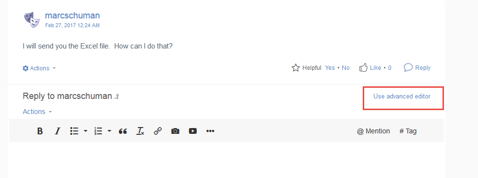

marcschuman
I will send you the Excel file.  How can I do that?
12,820 Views
kerryzhou
Hi Marcschuman,
   Choose advanced editor, then zip your excel and attach it.

Hi Kerry,
One more thing that I would like to point out.  If you look closely at the plot that I posted, you will see that where the vertical gap is, in fact the two segments overlap in the X dimension.  If you look at the numerical data that I sent, you will see that what is happening is that the ADC output is jittering between e.g. 56 and 64 for several steps.  This is exactly what one would expect if the ADC has as huge DNL error (many missing steps).  The input and conversion noise is causing the output to jump between the two adjacent available codes--which are 8 counts apart.
I hope this will really convince you that it is not a case of dropped data points.  The two discontinuous segments clearly overlap in time.  And the codes 57 through 63 are *never* present.
The question is whether this is inherent in the chip hardware, or if there is some software mediated setup that is responsible.

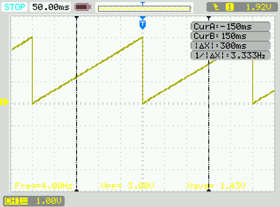

marcschuman
Hi Kerry,
Thank you for all the work that you have been doing to investigate this problem.  Unfortunately I don't think that the test ramp you are using has enough resolution to see the problem that we are seeing.  The discontinuity that is a problem for our application is 8 lsb's, with a reference voltage of 2.5V.  So that is only about 5 mV.  The step size of your ramp is already larger than that.  Also the noise floor is rather high.
The test signal that we are using is generated with a PWM output.  It is running at 4 kHz with a master clock of 48 MHz, so the resolution is 1/12000.  That is scaled over the input range of the ADC, so we get about 1/3 LSB per step.  The PWM output is filtered with a 4th order Low Pass Filter at 100 Hz, so the result is a very clean test signal that is inherently linear.
The reason that I feel sure that the problem is in the ADC is that the jump occurs at every multiple of 64, precisely over the 8 counts preceding the boundary.  If the problem were in the test signal, it would not line up with the ADC codes so precisely.  Voltage and timing offsets would cause it to appear at different places over the course of the test.  Similarly, if there were some problem saving or reading out the results from the ADC, it would not align perfectly with the actual numeric code values like that.  It doesn't matter how fast we run the ramp or where in the ramp we start.  The jumps always occur at ADC codes of (n * 64) - 8.  This really *has* to be something happening in the ADC.  The only thing I'm wondering is if there is some setup process for the ADC that we are not doing correctly.
I can't send you our entire test code because it is integrated into the complete application, which has more than 100 files, some of which are proprietary.  But I did copy the important ADC parts out in an earlier post.  At thsi point I don't have time to set up your application on our hardware.  I was hoping that you would be able to confirm the performance of the ADC, and that you might be able to see something about our ADC setup that would explain the problem.

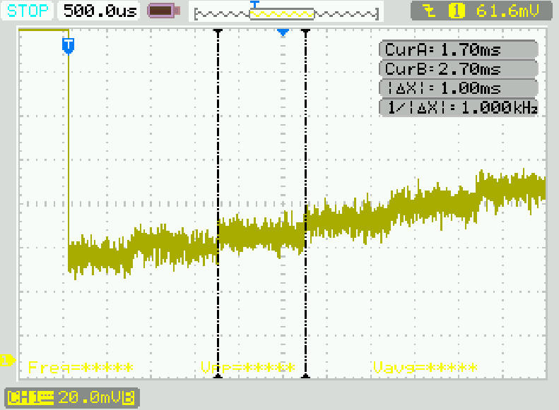

kerryzhou
Hi marcschuman,
  1. You said your test signal is very precise, please share your test signal wave in the oscilloscope. Post the picture.
  2. I don't need your whole project, just as I said, copy a project, delete all the other important code, just leave ADC code which can reflect the problem, it should contains the code segment how to save the several 64 datas, how to printf it. Especially in the loop code about the adc.
   The code you have shared can't see how you save the adc result, how to printf out, this is important to check the data continuous problem.
    From your post picture, it seems you missed one or two adc points, and the slope never changed. if it caused by the error(DNL), it won't be so regular. That's why I think it caused by the software.
3. All the data in our datasheet has been test, after contact with the according department, the datasheet data is reliable.
Kerry

kerryzhou
Hi Marcschuman,
Please also use the oscilloscope to test your ramp wave, whether it have the jump after zoom up. Whether it is really 1/3 LSB step as you said.
Kerry

kerryzhou

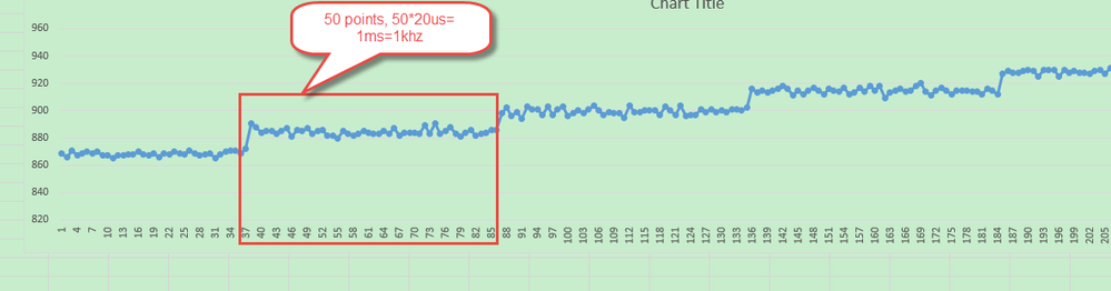

Hi Marcschuman,
  Sorry for my later reply.
   I test it on my side, now share you my test result in the LPCXpress LPC11U68 board.
In put wave:
My function waveform generator may not as precise as yours(it is just 8 bit), from the wave, it has the small jump in the rising wave.
The ADC convert data, this is just part of the sawtooth wave.
I saved 1000 points, printf data:
Zoom up the wave in the red frame.
  From the overall wave, the data is rising. The jump in the wave should caused by the original wave in my side.
My ADC trigger is using the systick, 20us do one ADC trigger, and save the convert result, then save it to the buffer, after the counter reach 1000, it will stop the adc convert, and printf the 1000 adc results. From the above result, every stage is about 50 points, one pints is 20us, so 50*20us is 1000us=1ms=1Khz, just like the original wave.
Send you partical test  data:

The above is just my test result.
Kerry

marcschuman
The Y axis is giving actual raw ADC values.  The X axis is the step number of the staircase waveform being input to the ADC, where each step is about 1/3 lsb.  The spot where you ask on the graph "How many lsb in this area" is 8 lsb.  The jumps in the recorded data are always 8 lsb, and they happen at every multiple of 64 in the ADC results.  That is, there is always a jump from ADC output (n * 64) - 8 to (n * 64).  The maximum DNL specified by the datasheet is 2.5 lsb.  But the actual DNL I am seeing is 8 lsb, and that happens regularly.  This means that the "12 bit" ADC in the chip is actually only usable as a 9 bit ADC.
I can send you an Excel spreadhseet with all of this data if you have a way for me to do that.  But here is a sample, which covers the area of the jump in the graph above.  Step is the input step number, and counts is the raw ADC value:
