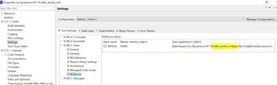

We are designing a bootloader for customer product firmware update.
In LPC54114 mutli core application, there are M4 and M0 core and they have their own output bin file .
I would like to confirm that if I build slave project first then build master project ?
Is the output .bin file in debug folder of master project is already included both M4 and M0 output?
So I only need to flash the "lpcxpresso54114_mailbox_interrupt_mailbox_interrupt_cm4.bin" file in master project is enough for the dual core application. Please confirm.

For dual core project, we build slave project first then build master. Thus the slave generated image will be added to master during building master. That's to say, master image includes slave.
Below is a master project setting that links of slave project:
When download master project, both master+slave images are downloaded.
