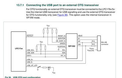

I want to use otg in LPC1754. Does it need an otg transceiver?
1,500件の閲覧回数
Hello @jalilisahar
Yes, For OTG functionality an external OTG transceiver must be connected to the LPC176x/5x:
Use the internal USB transceiver for USB signalling and use the external OTG transceiver
for OTG functionality only.

Hello @jalilisahar
