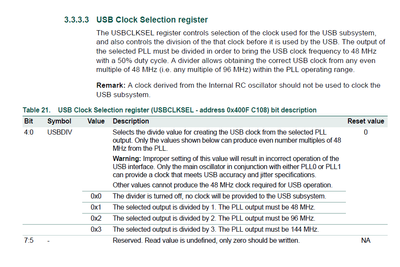

I think that you have to enable the USB gated clock before you write the LPC_USB->OTGClkCtrl = 0x00000019.
You can enable the USB gated clock with the line:
SYSCON->PCONP|=1<<31;
Pls refer to section 3.3.2.2 Power Control for Peripherals registers in UM10562.pdf

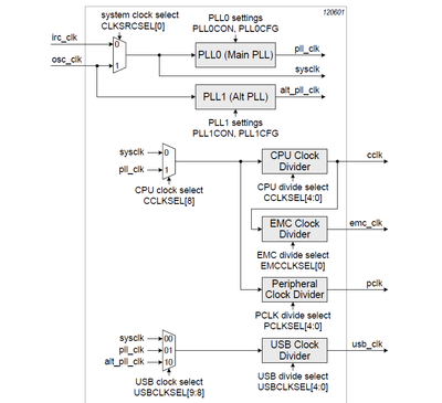

If you still can not, i suppose you have to enable the 48MHz USB clock
Hope it can help you
XiangJun Rong

Pls try to set the USBDIV with a non-zero value, you'd better get 48MHz USB clock by configuring the register including the USBDIV bits and USBSEL bits.
This is the procedure:
1)LPC_SC->PCONP |= 0x80000000
2)LPC_SC->USBCLKSEL=0x01|xx;
3)LPC_USB->OTGClkCtrl = 0x00000019;
4)checking the LPC_USB->OTGClkSt register
XiangJun Rong
