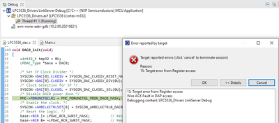

I try to create own configuration routine for DAC0 of LPC5536. I derive the configuration routine from the driver example "lpcxpresso55s36_dac_1_basic".
Now I encountered the following problem. In a code line of my configuration routine
PMC->PDRUNCFGCLR1 = PMC_PDRUNCFG1_PDEN_DAC0_MASK;                       // 0b - DAC0 is powered
the debug session crashes.
Unfortunately I can't find the error. In the driver example there is not this problem.

Please can someone help me to find the problem?
1,493 Views
How about debug DAC demo under SDK?
