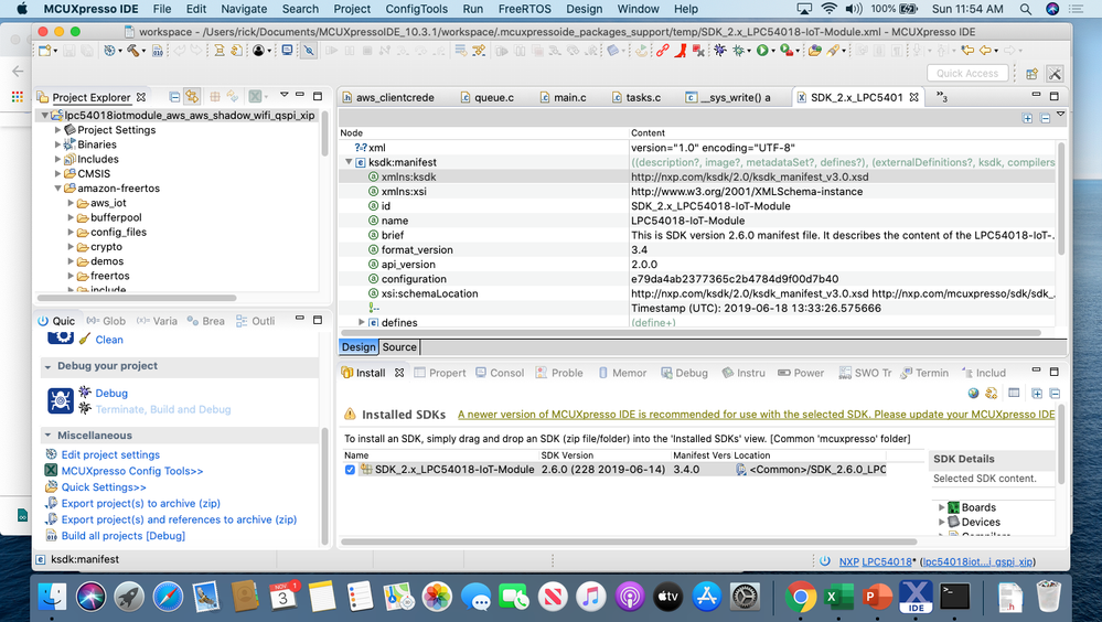

The SDK is :
The IDE is :
MCUXpresso IDE v10.3.1 [Build 2233] [2019-02-20]

However I am currently using MCUXpresso 11.0.0 and the SDK version I have is 2.6.0. Could you please confirm the SDK version you are using as well?
Also could you provide a small description of your process, what it is being updated?
Sabina
4,295件の閲覧回数
ricktseng
Hi Sabina,
Thanks for the reply. The SDK is 2.6.0(228 2019-06-04) : SDK_2.x_LPC54018-IoT-Module. The MCUXpresso is MCUXpresso IDE v10.3.1 [Build 2233] [2019-02-20]. This example is to update the AWS iot shadow state every 5 seconds:
