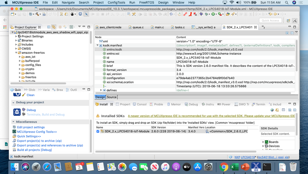

The SDK is :
The IDE is :
MCUXpresso IDE v10.3.1 [Build 2233] [2019-02-20]
Once it fails , it will never be able to publish again. The only way to fix it is to terminate the debug session and start over again from beginning..

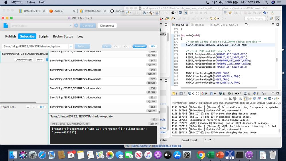

>>> Adding MQTT Fx Client
My AWS iot thing is OK.. I can see the shadow update message from Mqtt Fx Client. As you can see from the attached log , the errors happened after many successful publishes. I could duplicate the error if I re-run the program. The time to get the error message is random. Sometimes it runs more than one hour to show the error , sometimes errors come out in 10 minutes.. Anyone see something like it ??
