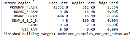

I have LPCXpresso54608 evaluation board ( OM13092 ). I use Mcuxpresso Ide and sdk examples. I chose one of sdk examples and wanted to relocate all data in external sdram. I added pin_mux.c settings to use sdram and used a function to init sdram in main function ( BOARD_InitSDRAM() ). Then, I built and released project.

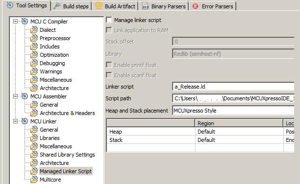

Opened it and arranged little bit and activated it from Project menu. Project>Properties>C/C++ Build>Settings>Tool Settings>MCU Linker>Managed Linker Script. Deactivated Manage linker scripts and selected my own linker script and its path.

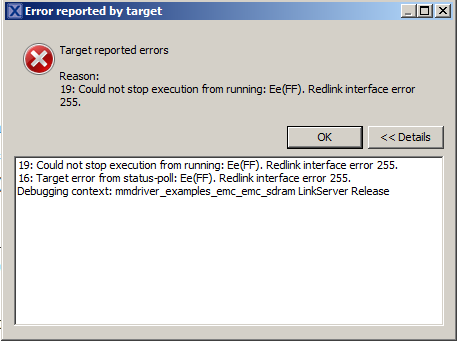

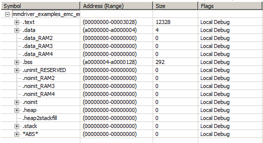

I know almost nothing about linker scripts file so I might(definitely did) make a mistake. and then I see datas and others files located in Board_Sdram. But I could not press 'Resume Debug Session' button because it was unvisible. I pressed button 'Terminate All debug Sessions' and I got a new error window I made a mistake somewhere and I am asking where I might make a mistake ?
What did I do in Release.ld file? Here it is.( just deleted all 'SRAM_0_1_2_3' texts and wrote 'BOARD_SDRAM' instead.)
