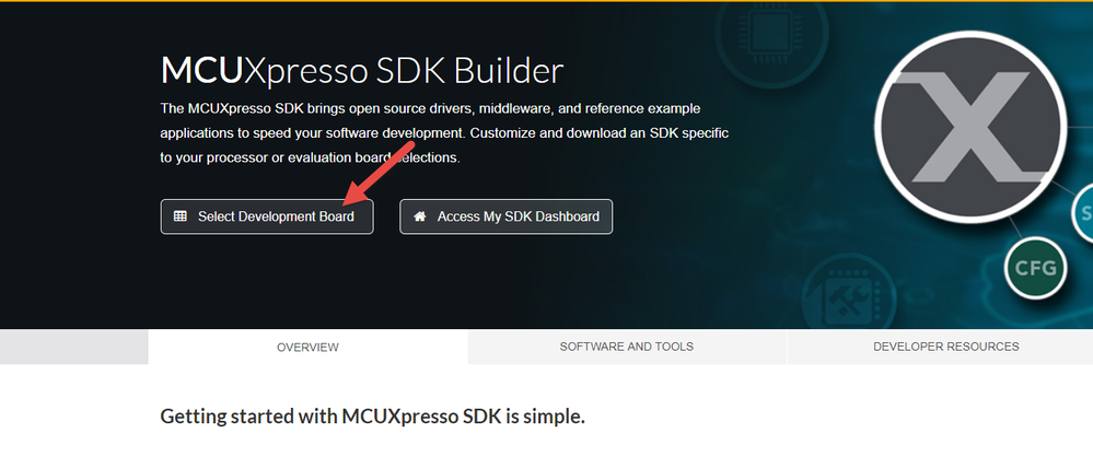

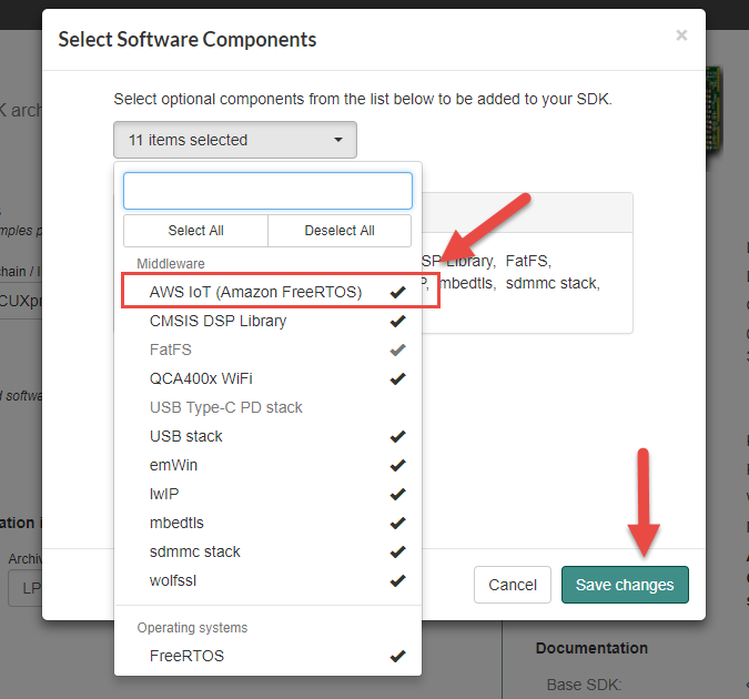

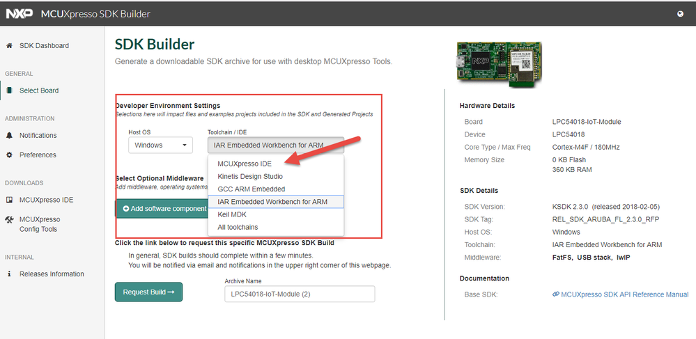

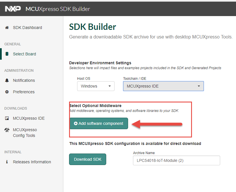

1. Please go the following link:
Welcome | MCUXpresso SDK Builder

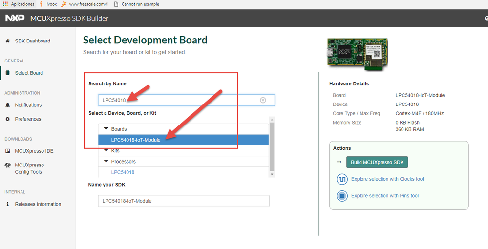

2. Click on select development board

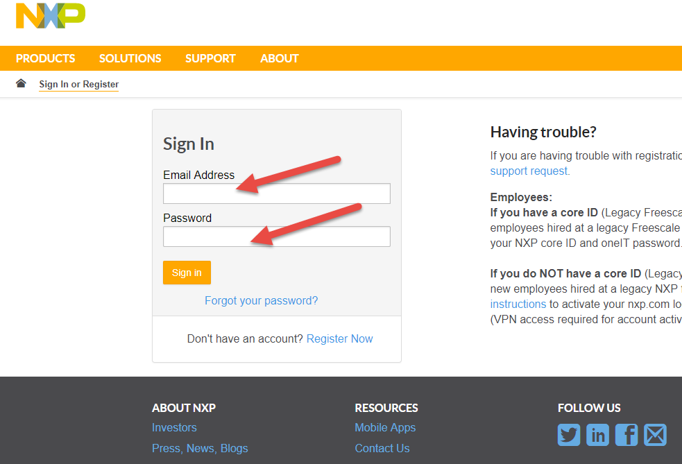

3. You need to sign  in.

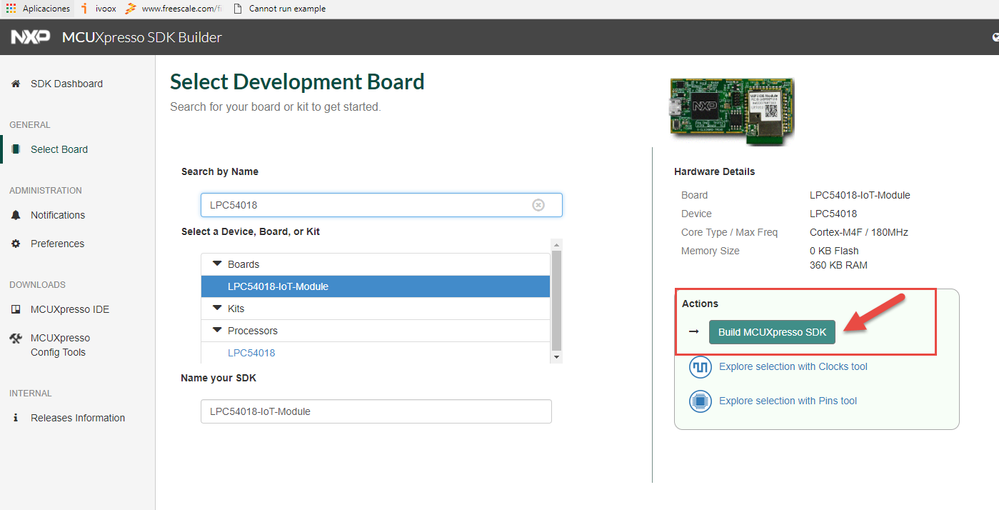

4. Select the board and name.
5. Click on the Build MCUXpresso SDK
6. Select the IDE

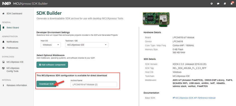

7. Click on Add Software component
8. Select the software component needed  and click on save changes.
9. Click on Download SDK.

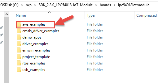

10. After download the SDK you will find the aws_examples
I hope this helps,
