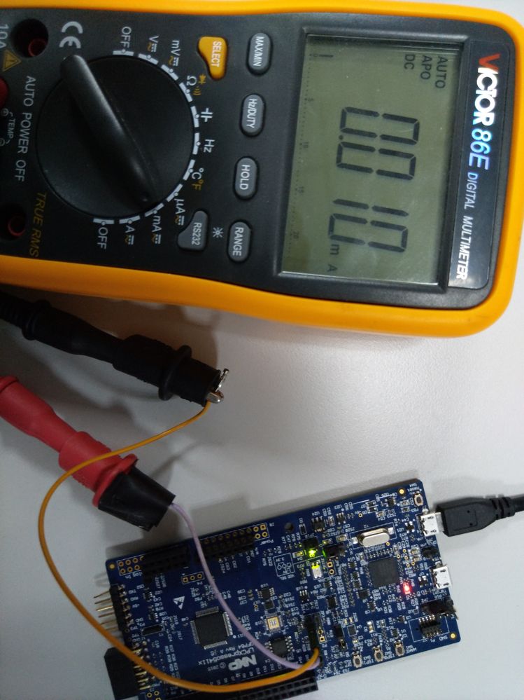

I want to measure the power consumption of the MCU on the OM13089 board;
according to the instructions of AN11799 I can probe the current on JP4; the issue that even in reset I am measuring 68mA.
Then from that current level I can see the normal variation on the consumption due to different power level modes.
Did someone else had this issue?
Any hint would be very appreciated.
B.R.
L

Hi Catosh ,
for the opportunity to serve you. I've done some testing and the AN11799 works well, I'd like to exemplify the testing results.
            Fig 1 Normal working mode

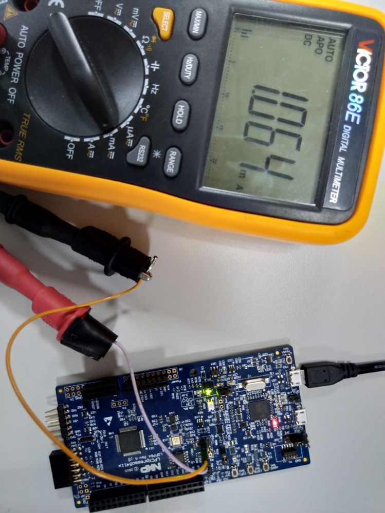

                              Fig 2 Sleep mode
