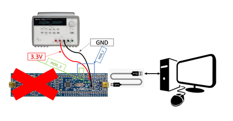

I order OM13066 board, which is LPC11U24 evaluation board. I want to program LPC11U24 through USB interface, so I isolate this board target side, and provide the independent power for LPC11U24. I also follow UM10462 and reference one post in this community.

I can see "CRP DISABLED" drive displayed on my PC, and I also see one bin file which is "firmware.bin" , and its date is 2/6/2009. I delete this file and drag my own bin file. After reset the board by shorting PIO0_0 to ground, unplug PIO0_1 from ground and unplug PIO)_3 from 3.3V, the board is still not working. When I re-check the "CRP DISABLE" drive, the file I loaded in is disappeared, and old file "firmware.bin" is back, so I'm wondering which step is wrong. By the way, I also padded my own file to 32kB, because document an11305 indicates

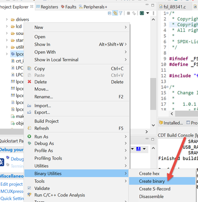

ZhangJennie
HI
afx file can not be accepted. firmware can only accept bin file.
To generate bin file,  refer below screenshot
make sure rename it as "firmware.bin", lower case

coolxiangm
Hi Jun,
This is what I did to get the original binary file, but this file is not padded to 32KB, so
1. do we need to pad file to 32KB?
2. Is there any other hardware setup trick?
When I supply independent power to LPC11U24
I have PIO0_1 connects to GND, and PIO0_3 connects to 3.3V (all the time). If I leave PIO0_3 floated, the "CRP DISABLED" drive display and disappear, so PIO0_3 should connects 3.3V. I also screenshot my hardware setup. Please take a look. If I setup anything wrong, please tell me.

ZhangJennie
Yes, please pad it.

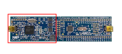

coolxiangm
"download application with debugger"- if you mean left side of the board, I successfully load file through left side, but the file type is .axf, and then I applied standalone at right size, the right part of circuitry is work. I can see LED is blinking. But it is still not able to reprogram from right side.

ZhangJennie
Most likely it goes wrong in the first step, generation of the bin file.
The bootcode of the LPC checks whether a valid flash signature is found at a specific location, probably this signature is missing in the .bin file.
This process is explained in the User Manual ( https://www.nxp.com/webapp/Download?colCode=UM10462&location=null  ), chapter '20.7 Criterion for Valid User Code'
You can also refer this article to add checksum.
https://community.nxp.com/t5/LPC-Microcontrollers-Knowledge/LPC8N04-LPC-Boot-ROM-checksum/ta-p/11261...
Have a nice day
Jun Zhang
6,352 Views
coolxiangm
I think this reply is the right direction. I will try to correct checksum, I will get back to you soon.
