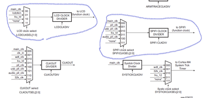

You can download the code to spifi flash and check the SYSCON register to know the LCD driving clock, SPIFI driving clock frequency,cpu clock frequency.

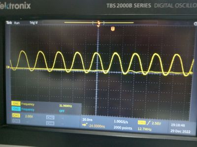

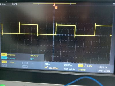

In XIP and NO-XIP both the frequency are configured as same.But the execution speed is low while compare with the NO-XIP. what is the reason behind to slow down the speed of execution in XIP Mode.Is there is any other option to increases the clock speed in XIP Mode.
I was attached the images of frequency of XIP and NON-XIP and also attached the project file of XIP and NO-XIP in ZIP File.
NO-XIPNO-XIP  XIPXIP

1.I was download the SPIFI flash and set the clock as 96MHz.
2.And we are not used the LCD Driving clock because TFT was connected with the FLEXCOMM 9.And the clock was set as 96 MHZ.
3.Then the CPU Clock was in 12 MHz.
4.Finally there is no change in speed of the display same as before.

This is my guess, Running in internal SRAM is faster that that of running in spifi flash, which leads to the fact that the core can not update the data in display buffer in time. If it is the case, pls simplify the code to reduce the core load.

Hi XiangJun Rong,
According to your suggestion I was reduce the core load to flash the code in TFT Display.I got the data in my display.But the speed quite low compare to NON-XIP. I was attach the Video file of XIP and NON-XIP Execution in display.
8,300 Views
xiangjun_rong
I have played your *.mp4 file, when you run in XIP mode, it appears that core clock is very low compared with the running in on-chip RAM, pls check the core clock, LCD driving clock and pixel clock frequency in XIP mode.
