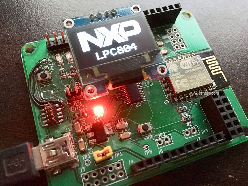

Hi Everyone,
This simple demo of displaying text and image on OLED screen (0.96 Inch & 128x64 pixels). OLED is interfaced to LPC804 with I2C connections. LPC-IoT board is used in this project.
Pin Connections:
OLED->PIN Vcc   - 3.3v
OLED->PIN Gnd  - Gnd
OLED->PIN SDA - LPC804->P0_7
OLED->PIN SCL - LPC804->P0_14
Code:
    OLED_Init();
    OLED_Clear_Screen();
    OLED_DrawImage(0, 0, logo_nxp);
    OLED_PrintText(6, 24, text_nxp);
Download the example from here https://gitlab.com/mcucodes/oled-display-lpc804
Happy Coding!

carstengroen
Senior Contributor II
Link not working (project not found on Gitlab) ?
3,432 Views
ashokfair
Yeah the link was incorrect! now fixed thanks
