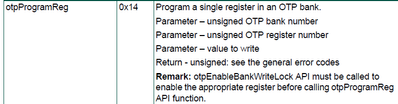

To use the OTP API, the main system clock must be running from the 12 MHz clock. The
OTP controller has critical timing values programmed so that running from clock speeds
above 12 MHz will result in inconsistent fuse burning and will yield unpredictable results.
2) "Also, do we have 2 or 4 banks of user writable registers available?"
->> There is OTP API:
Alice
