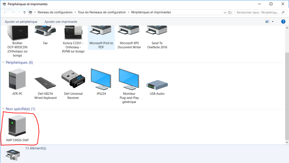

I already test this method, and i think that my big problem is doing these follong steps :
- Hold down the reset button then disconnect and reconnect the USB cable.
- You should see a drive called "CRP_DISABLD" appear in your file manager, like a USB memory stick would.
There is no drive, or disk or whatever. There is an automatic installation for windows drivers (despite the deactivation in peripheral manager) then i see this :
I can't open it or do something with it. And i try to uninstall it hold down the RST button unplug and plug the USB, nothing works...
I test every possibilities to try to install driver for LPC11U35 debug probes...
Do you think that my board is broken ?
I mean it's weird cause i bought it a week ago...
Nevertheless thanks for your help i will try to contact the technical support by a ticket.

Hi Arthu,
From your device manager screenshot we can see that your debug probe isn't going into DFU mode for firmware update, as you have observed. This board can also be forced into this mode by inserting JP5 and power cycling (then remove JP5 once you've done the update, then repower). Can you try that?
If that doesn't work then it does look like a faulty board, which we can replace.
