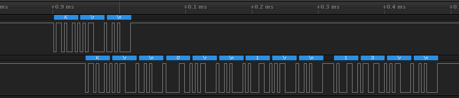

- When sending the ReadBootCodeVersion command the process is describe in datasheet as:
-> "K\r\n"   // Send command from host
<- "0\r\n"   // CMD_SUCESS from target
<- "<major><minor>\r\n" // should be interpreted as <major>.<minor> with <major> a single byte and same for <minor>
But what is see is :
<- "<major>\r\n"   // "1\r\n" in my case
<- "<minor>\r\n"   // "13\r\n" in my case

I'd like to recommend you to capture the communication between the Host tool and LPC824 via logic analyzer, it will demonstrates the more information about the ISP command operation, definitely, for cross-validation, it's best to do same testing on Flash Magic.
And I was wondering if you share the testing result, it will help me to figure it out.

olivierledoeuff
After a long time i finally got a logic analyser. This is what i captured. So version is 1.13?Sans titre.png

Hi Olivier Le Doeuff,
1) This is what I captured. So the version is 1.13?
-- Yes, it's. You can also use the Flash Magic to validate it.
