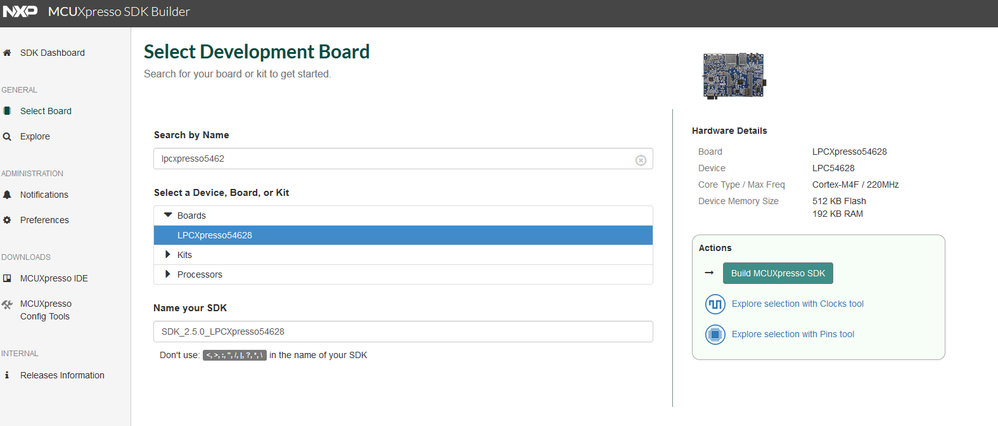

How about MCUXpresso SDK ? It includes development drivers and demos:
https://mcuxpresso.nxp.com/en/builder

Hello Ritesh Prajapati,
1)  Dowload SDK is simple, just input your board name or processor name, select IDE,
add middleware, operating systems, and software libraries to your SDK, then can download.
About detail steps you can refer the below thread:
Generating a downloadable MCUXpresso SDK v.2 package

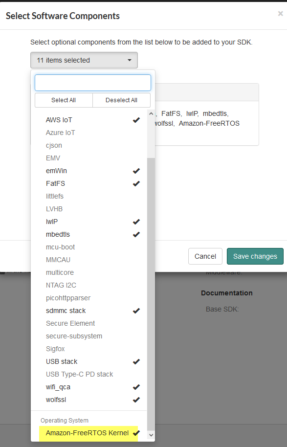

2) "We have checked that there is no any RTOS "
->Now it support FreeRTOS , when download SDK package, you can choose it :

Hello Ritesh,
LPC54628 only support MCUXpresso SDK , and the below link is download address:
Because the SDK supports many LPC and Kinetis products, so we need input some options
to choose our need chip or board.
