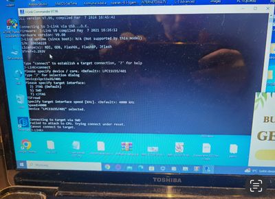

Hi I’m trying to read LPC11U35 with jlink via swd or jtag, however I don’t know which pins are required to the jlink for connection?
if someone could help me with what are the crucial pins and best way to read it thanks

imran333
Heres picture of jlink

Your post suggests you speak about an unknown board, or at least a board of unknown status.
First thing would be to check if the power supply looks correct. Measure Vcc directly at the MCU pins, and check if the current consumption seems ok.
Then I would check the logic levels at the JTAG/SWD pins with power on.
Only then it makes sense to attempt a connect.
An existing firmware can reconfigure the debug pins to general IO at runtime, so try multiple times, and cycle the power while trying to connect.
Existing firmware can also enable Flash protection, in which case the cards are stacked against you.

Hi I’ll try what you said, it is board for a steering wheel for gaming, I’ll check model number on it, I even tried by removing the LPC part but that never worked, if it’s protected then would I still not recognise the part or atleast get some info in jlink ?

I’ve tried on both LPC11U35 but can’t get no connection

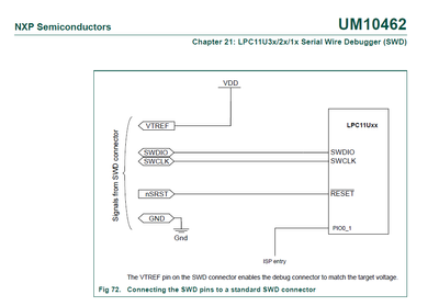

xiangjun_rong
The LPC11U35 only supports SWD port, so you can use SWD port to download and debug.
This is SWD port connection with probe such as  J-Link probe.
In detail, you have to connect the SWDIO, SWCLK, Reset and GND of the LPC11U35 to the J-link probe.
For the ISP pin(PIO0_1 and PIO0_3), pls refer to section 20.2 Bootloader in the UM10462.pdf
Hope it can help you
