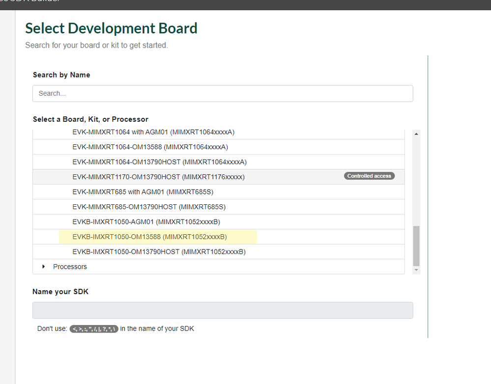

I downloaded SDK SDK_2.8.0_EVKB-IMXRT1050from the link you have mentioned. But it does not have evkbimxrt1050_om13588 folder. So I can't acces the example you have mentioned.Do I need to add any component specifically while building the SDK from the link?
6,668件の閲覧回数
kerryzhou
Hi Suhel Mulla,
  No, you download the wrong SDK, you need to download SDK_2.8.0_EVKB-IMXRT1050-OM13588, it unders the Kit item, not the board, please check it again, it is not the controlled access, so you should can download it.
