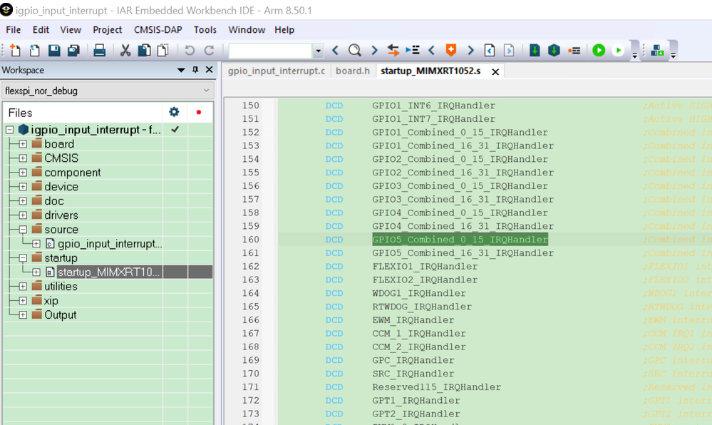

 \SDK_2.8.0_EVKB-IMXRT1050\boards\evkbimxrt1050\driver_examples\gpio\input_interrupt
   From the startup_MIMXRT1052.s, you can find the real handler name:
Board.h, you can find:
#define BOARD_USER_BUTTON_IRQ_HANDLER GPIO5_Combined_0_15_IRQHandler

It finishes the interrupt handler register.
