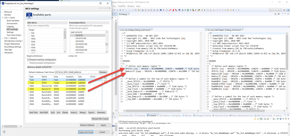

I'm trying to use the LPC4370 (lpc link2 evaluation) in dual core mode: M4+M0App.
I have errors which I can not understand while compiling the M4 (master) project.
Here's the output for the memory map after compiling the m0app project:
Building target: mc_tut_m0app.axf
Invoking: MCU Linker
arm-none-eabi-gcc -nostdlib -[...]

The RamLoc72 is not used and I got the following error.
c:/nxp/lpcxpresso_8.2.2_650/lpcxpresso/tools/bin/../lib/gcc/arm-none-eabi/5.4.1/../../../../arm-none-eabi/bin/ld.exe: M0APP execute address differs from address provided in source image
collect2.exe: error: ld returned 1 exit status
make: *** [mc_tut_m4xm0app1.axf] Error 1
As I put in bold, the Master project is correctly allocating the Slave M0App code in the 2nd (external) Flash, as I asked during the creation wizard.

Hello Andrea,
In M4 project,  please  put RamLoc72 part at second RAM  ( follow RamLoc128) to have a try.
If still have this error, please send your project to me, I will help you to check it on my side.

Hello Andrea,
I have help you change the memory setting of M4 project. The memory M0 project used, we need
put them into second flash part and second RAM part:
Please test the project I attached, hope it helps.
