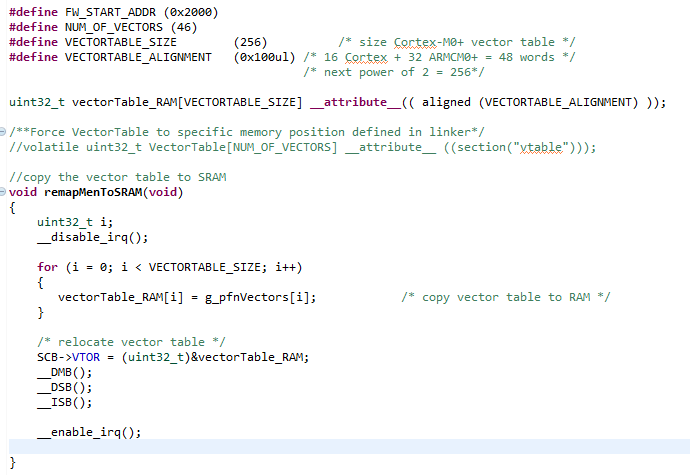

I'm working with LPC51u68, and I want to copy the vector table from flash to SRAM0.
Vector table is at 0x00000000 at flash and need to go to 0x20000000, from what I understand from the user manual.
I used the VTOR register, and developed the following function:
What do you think of my approach is it correct? I am having doubts on using g_pfnVectors defined in the srtatrup file, is this really my vector table?
Thank you.
Carlos Medeiros

One more question, I understand the CopyInterruptToSRAM(), but after this I need to change the content of the VTOR right?
Quote:
BTW, do you development Secondary bootloader ? If yes, are you sure remap data from 0x000 to SRAM?
I have my bootloader in flash and my APP on SRAM, so I need the remap function when I want to do a jump to APP or jump to boot.
Thank you,
Carlos Medeiros

Hello  Carlos,
Yes, you need to change the content of the VTOR , also need to configure SP before jump, the code like below:
typedef  void (*pFunction)(void);
pFunction Jump_To_Application;
static uint32_t JumpAddress;
void run_to_app(void)
          JumpAddress = *(__IO uint32_t*) (ApplicationAddress + 4);
          /* Jump to user application */
          Jump_To_Application = (pFunction) JumpAddress;
          /* Initialize user application's S4tack Pointer */
          __set_MSP(*(__IO uint32_t*) ApplicationAddress);
          // the contents of the first address of the image, not the address itself.
          SCB->VTOR  = ApplicationAddress & 0x1FFFFF80;
          Jump_To_Application();

Hello Carlos Medeiros ,
You can directly define the Destination address to 0x20000000, Source address is 0x00000000,
like this:
void CopyInterruptToSRAM(void)
    unsigned int * flashPtr, * ramPtr;
  unsigned int * uLimit = (unsigned int *) 0x100;
        ramPtr = (unsigned int *)0x20000000;    //load RAM starting at 0x20000000,
        flashPtr = (unsigned int *)0x0000;            //start of interrupt vector table
      while(flashPtr < uLimit)
                *ramPtr = *flashPtr;
                ramPtr++;
                flashPtr++;
