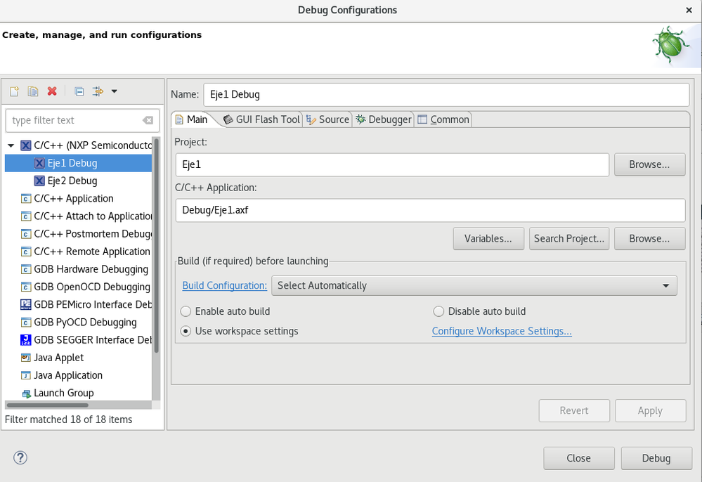

Hi support, I have version MCUXpresso IDE v10.2.0 [Build 759] [2018-05-15].
I created a new workspace and a new one project for LPC1769 expresso too.
When I try debug it the following error appears:
Please, could you help me?
BR!
Mariano

Hi Mariano,
I already gave the engineering team a heads up.
Thanks for your files. But they do not include the launch configs.
Can you turn on 'shared file' (see Sharing Debug Configuration with Eclipse | MCU on Eclipse )?
Just a wild guess: maybe this is your problem, that you don't have the launch config stored as physical file? It should work that way too, but I'm always using 'shared file'.
I hope this helps,
Erich

Hi Mariano,
We have imported your workspace onto a local test machine and see debug working without issue.
The logs you have supplied show a problem locating require files ...
Please can you tell us which host and version (linux, win etc.) you have installed MCUXpresso IDE onto. Also, is your workspace located on the same machine as this installation?
We can see file references at: /home/juliancho/Documentos/Facultad/InfoII/R2052/2018/Sources/LPC1769/Workspace2018/Eje2/Debug/../src/Eje2.c"
Yours,
MCUXpresso IDE Support

Hi dear support,
Thank you for your reply.
I'm using Debian 9.4 OS (natively).
My workspaces in general aren't in the same location of IDE installation.
A couple hours ago, I responded to Erich that my trouble was fixed with his last recommendation:
   With "shared file" in the debug configuration.
Thank you for everything!
Mariano

BlackNight
I would delete the launch configuration and try again (with probe discovery), maybe your launch configuration somehow is bad. But as you have a new workspace and a new project that might not be the problem.
Does it happen for a different project too?
The other thought I have: can you check or post the .metadata/.log file inside your workspace?
I hope this helps,
Erich

marianovedovato
Hi Erich, thank you so much for your help.
Yes, it happens with other new project too that I created in the same workspace or new one.
The log file shows this:

!ENTRY org.eclipse.core.jobs 4 2 2018-07-22 09:02:34.570
!MESSAGE An internal error occurred during: "Launching Eje2 Debug".
!STACK 0
java.lang.NullPointerException
    at com.crt.dsfdebug.dsf.override.CRTGdbLaunchDelegate.getLaunch(CRTGdbLaunchDelegate.java:91)
    at org.eclipse.debug.internal.core.LaunchConfiguration.launch(LaunchConfiguration.java:812)
    at org.eclipse.debug.internal.core.LaunchConfiguration.launch(LaunchConfiguration.java:739)
    at org.eclipse.debug.internal.ui.DebugUIPlugin.buildAndLaunch(DebugUIPlugin.java:1039)
    at org.eclipse.debug.internal.ui.DebugUIPlugin$8.run(DebugUIPlugin.java:1256)
    at org.eclipse.core.internal.jobs.Worker.run(Worker.java:56)
Mariano
8,196 次查看
BlackNight
Hi Mariano,
thanks for sharing the log. It seems to me that there is a problem with the launch configuration and it fails to find the executable file. Could you share a screenshot what launch/debug configuration you try to debug?
Otherwise I think someone from engineering need to have a look, or maybe you even could share/post your project?
Erich
8,196 次查看
marianovedovato
Hi Erich,
Next are the screenshots:
With  Eje1 project (is the same result with Eje2 project):
Regard the projects or workspace, of course, here is the zip file:
Dropbox - Workspace2018.zip
Finally, I don't know how can I ask to engineering team. Can you?
BR!
Mariano
8,197 次查看
BlackNight
Hi Mariano,
I hope this helps,
Erich
8,196 次查看
marianovedovato
Hi Erich, thank you so much for your help and thank you very much for giving notice to the engineering team!
With that configuration "shared file" my problem was fixed, so now I can use the IDE smoothly.
Thanks for everything again.
Mariano
