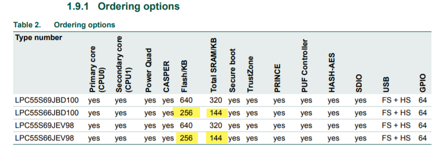

Have you try to enter into ISP mode before trying to debug? In addition, please have in mind LPC55S66 has smaller flash and SRAM than LPC55S69. Is there any chance your application is consuming all the resources? Please check image below.

Hi Felipe,
as you can see here https://community.nxp.com/message/1195953  it toke me quiet a time to get this data from NXP. It would be nice if you could verify this behaviour. It is happening with both examples from the LPC55S66 SDK2.6.2 as with own generated files. Running it on a LPC55S69 solves the problem.
