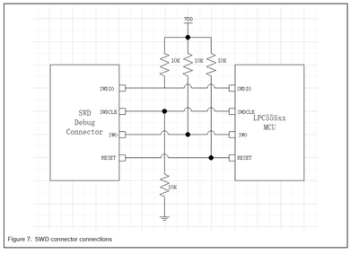

Hi Wanda,
have a look at AN13033 "Hardware Design Guidelines for LPC55(S)xx Microcontrollers".
Chapter 6 provides a sample schematic for the connecting debug signals:
The pull up/down resistors are recommended. Give it a try and add them.

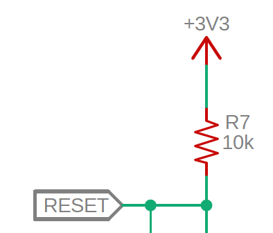

wandaWilliams
Hi @danielholala
The only pin that is pulled up on my board is the RESET pin with a 10k resistor.

danielholala
Senior Contributor II
Hi Wanda,

wandaWilliams
Hi @danielholala, this is super helpful. I used 15k resistors as that is what I have ready access to. It definitely gets me to see changes on the signals. However strangely the RESET pin is toggling like a clock. I had expected (like in SPI) that the RESET pin to stay low (and SWCLK) for the duration of the SWDIO transaction. It looks like I have more work to do; but this is super helpful. Thank you!

danielholala
No pullup/pulldowns? Maybe you could reproduce the relevant part of the schematics for the SWD interface.
