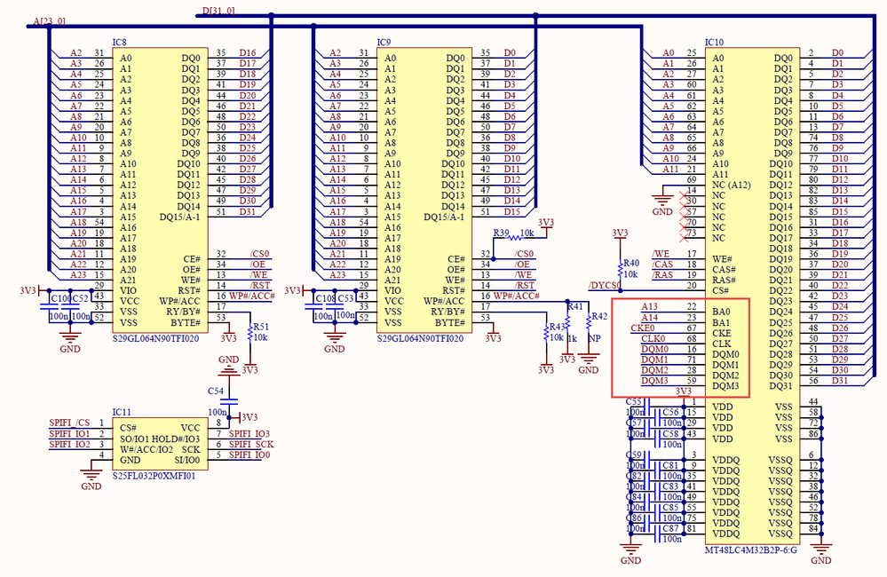

jeremyzhou
Hi Gaurav More,
Thanks for your reply.
According to the AN11508, the clock configuration supports two kinds of modes, and they are select freely the developer.
For the MCB4357 board, it uses the EMC_CLK0 to drive the SDRAM MT48LC4M32B2P when the EMC_CLK0 pin works as the function 0, in addition, the EMC_FBCLK0 feature is enabled too.
I've attached the schematic about the MT48LC4M32B2P connection, and the related demo project, please refer to it for details.
TIC

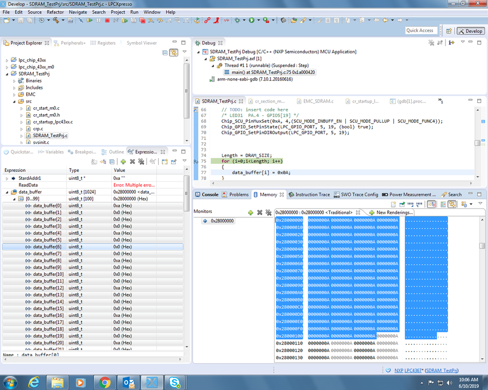

gauravmore

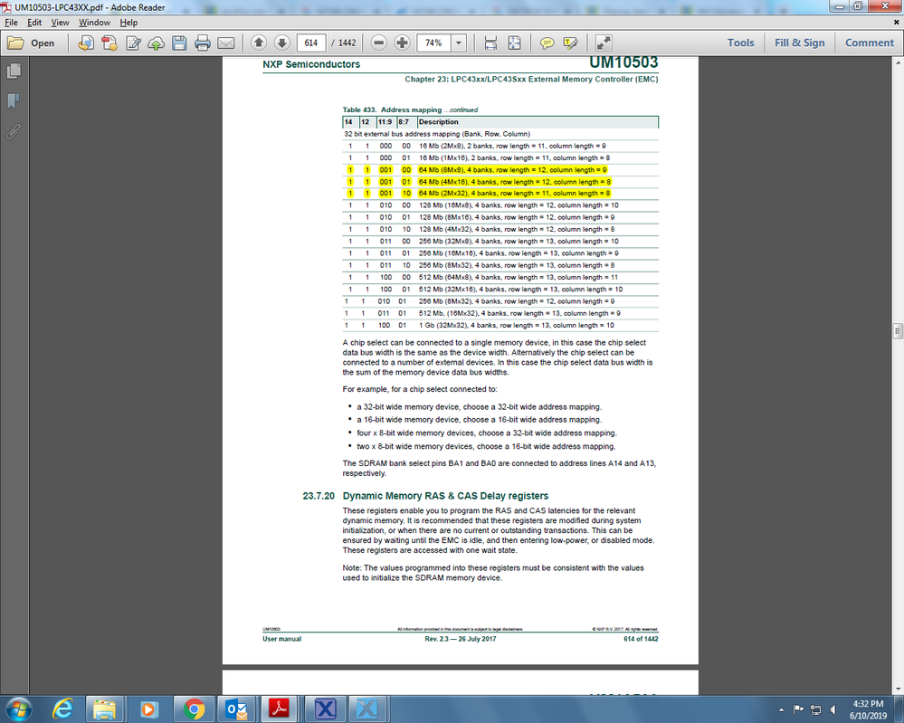

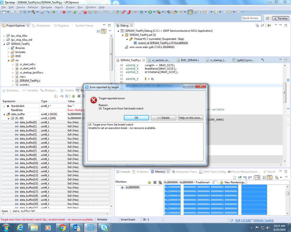

Hi Jeremy,
I check with my code for SDRAM and while running the code I found the following behaviour,
While loading the code and running the code it is observed that it is storing the data on multiple location.When I am running the code mentioned below with stepwise execution,
__SECTION(data,RAM8) uint8_t data_buffer[1024];
Length = DRAM_SIZE;
for (i=0;i<Length; i++)
data_buffer[i] = 0x0A;
I just run for i=0 and data_buffer[i] = 0x0A;
and then checked the memory. So follwing is the observation.
Instead of storing the data in only data_buffer[0] = 0x0A; sinze i=0 it is also storing the same value 0x0a in other locations as well refer the screen shot for observation.
Also one more observation is when I am stopping the execution stepwise and checking the data in expression and memory as shown below then again while proceeding for the next step then it gives below error
But if without the checking the debug value and running step by step  the it works but it is storing the value in all other locations as well as i have mentione above.
Also I would like to suggest you to please check my code with your board by doing the modifications in the code w.r.t  your eval board and check the behaviour. mean while i will check for the clock and other issues if exist.
There is one more observation reagrding the memory that we are using.
You can see highlighted part where is it mentioned the memory configuration. But similar memory configuration is not available in the user manual of LPC43XX.
is there a probelma related to this? Since the same behaviour is ther there after doing following method.
for (index = 0; index < 20; index++)
*(uint32_t *)(sdram + index) = 0xA5A5A5A5;
while(1)
Chip_GPIO_SetPinToggle(LPC_GPIO_PORT, 5, 19);
for (index=0; index<0xFFFFF;index++ );
//sdram = (uint32_t *)EMC_ADDRESS_DYCS0;
if (*(uint32_t *)(sdram + index) != 0xA5A5A5A5)
Chip_GPIO_SetPinState(LPC_GPIO_PORT, 5, 19, (bool) true);
while(1);
Here also it it writing the whole memory with 0xA5A5A5A5 instead of  only 20 locations.

jeremyzhou
Hi Gaurav More
Q1) I've not encountered a similar phenomenon as you mentioned when using below code
Length = DRAM_SIZE;
Q2) The highlight configuration is suited for the AS4C4M16SA.
Q3) I've not encountered a similar phenomenon when using the below code.
while(1)
while(1);
Note: I've done the above testing base on MCB4357 board, the demo code is based on the periph_memtest demo which is come from the LPCOpen library.
TIC

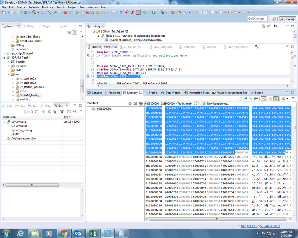

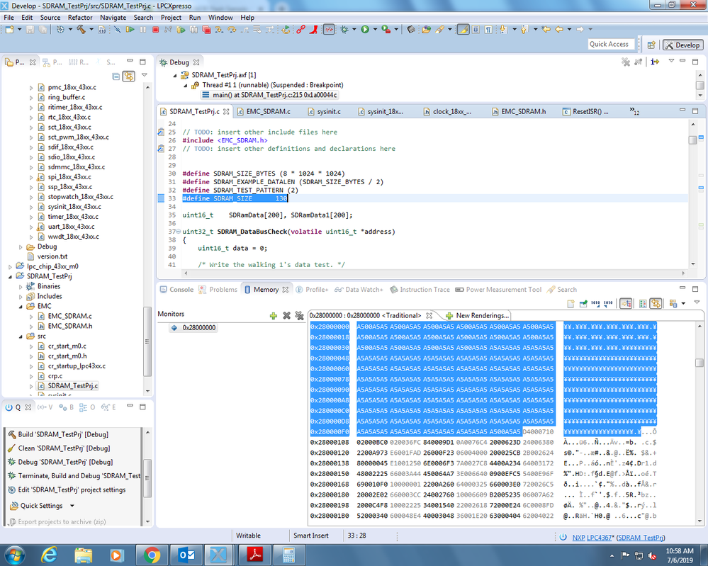

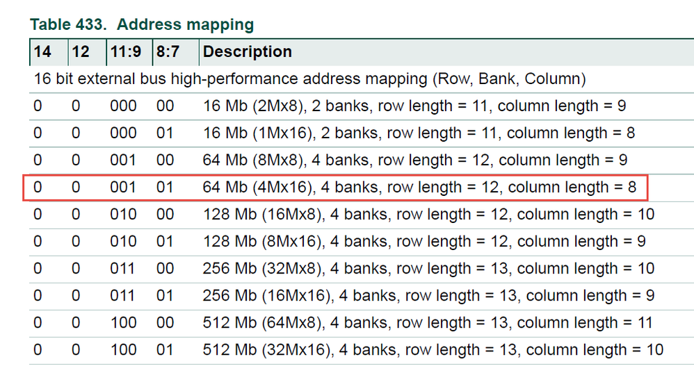

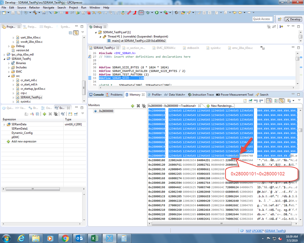

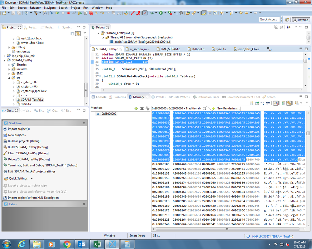

gauravmore
Hi Jeremy,
As per your input I the modifications in the code and also refered the application note (ANN11508) for SDRAM interface with LPC43XX.
After doing the modification I am able to write but the data written at the alternate address is not proper means not the one which  want to write.
Let explian in detail. I am writing
uint16_t Data = 0xA5A5;
uint16_t Data1 = 0x1234;
In alternate location. and I am writting data using following logic,
for (index = 0; index < SDRAM_SIZE; index++)
   if(Flag == 0 )
         sdramAddr = Data;
         *(sdram + index) = sdramAddr;
         Flag = 1;
else
         sdramAddr = Data1;
         Flag = 0;
if(*(sdram + index) != sdramAddr )
      while(1);
after cehcking the memory location 0x28000000,  below is the observation where it is writing 0x1200 instead of 0x1234 and it is happening only  for every alternate address address writing. it is writing  0xA5A5 properly.
It is storing  0xA5A5  at  0x28000000,  0x1200 at 0x28000002.. Likewise..
You can see it is writing 0x1200 and 0xA5A5 at every alternate location instead of writing 0x1234 and 0xA5A5.
Please let me know the reason for the same.  Also find attached code for your reference. in order to check if any configuration is missing.
Gaurav More

jeremyzhou
Hi Gaurav More,
Comparing with the previous project, I find that there's no
 difference to initializing the SDRAM except for the CLK0's configuration.

There is one observation in the functionality of SDRAM interfaced with LPC4367 in my customized board.
The observation is in the below mentioned code while writing the data
   if(Flag == 0 )
         sdramAddr = Data;
         Flag = 1;
else
         sdramAddr = Data1;
         Flag = 0;
      while(1);
when  #define SDRAM_SIZE    128
It works fine and writes proper in all the location. So as per my understanding I am able to write 0x28000000 to 0x28000100  means upto 256 bytes.
Patern mentioned below,
Address            Data
0x28000000      0xA5A5
0x28000002      0x1234
0x28000004      0xA5A5
0x28000006      0x1234
 like wise till  0x28000100  Which is correct one.
when  #define SDRAM_SIZE    129
Above 0x28000100 means if  address location is 0x28000102, it writes 0x1200 and it also corrupts the previous location as well, means from 0x28000000 to 0x28000100 address location by writing 0x1200 in every alternate location.
Address            Data
0x28000000      0xA5A5
0x28000002      0x1200
0x28000004      0xA5A5
0x28000006      0x1200
 like wise till  0x28000102 which is not correct.
Please let me know the reason for this behaviour mentioned above on very higher priority. IS there any thing missing in the code which is not allowing to write above 0x28000100 address location?
Gaurav More.

jeremyzhou
Hi Gaurav More,
Sorry for reply late.
If the SDRAM_SIZE becomes 129, it means that the writing byte will be 258 bytes which consist of 0x2800101 and 0x2800102(will be written: 0xA5A5) and the previous 256 bytes.
So it's correct.

gauravmore
Hi Jeremy,
Thanks for the reply.
As per you input  i did some more test to checl the behaviour. I made some modification in the code mentioned below and checked the behaviour
volatile uint16_t *sdram = (uint16_t *)EMC_ADDRESS_DYCS0; /* SDRAM start address. */
uint16_t  sdramAddr;
SDRAM_SIZE = 130;
for (index = 0; index < (SDRAM_SIZE); index ++)
   sdramAddr = Data;
 And after running the code  below is the result that i got whihc is different. I just wanted to check if  i write the same data accross al location what is the output? Some plase it is writing properly and at some places it is writing 0xA500 instead of 0xA5A5.
 You can see that it is writing randomly. Now I tried with the EMCCLK Delay 6 and 7 as well but still the same result.
What is the resaons please let me know..
Even i tried
memset((uint16_t *)sdram, 0xA5A5, 130);
but still the same result. It is not writing the data consistently.
I feel I am close to the solution but then again not getting the result.
Gaurav More
14,933 Views
jeremyzhou
Hi Gaurav More,
Please give a try with the address boundary is 32-bit aligned (that is
address bits [1:0] equal 0).
TIC
14,930 Views
gauravmore
Hi Jeremy,
You mean to say making the device 32 bit and then check. It so then i did that already but the same result. If not please explain what needs to be tested.
Also i am attaching the vedio where i did the testing  and I recoded the behaviour which you can see and comments on it .
I kept the previous code as it is before making 32bit change  and the first tested that. The behavious is as follow in breif.
I and writing 0xA5A5 in debugign mode step by step.
But when i write the first address it writes properly and when i write  for the second address then also it writed properly. but in debuging as run the for loop you can see the secodong address which was 0xA5A5, gets changed in 0xA500. and this happens continuosly.
Kinldy go through the Video.
Gaurav More
