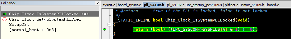

I'm trying to use a 32kHz clock on the RTC pins with an LPC54102. The subject mentionned previously (Wait 15 seconds for PLL to lock the input from 32KHz Crystal  ), but I still have this problem, even worst because the wait can be much longer. I need the PLL to generate a 96MHz frequency.
I tried the following :
- Change the SELx as define in remark in the application note (SELP=6, SELI=4 and SELR=0)
  => Still have long wait to lock
- Not using the Chip_Clock_IsSystemPLLLocked() function, and set a 100 ms loop instead.
  => The chip crashes. Need to manually handle the reset pin to be able to re-programming the chip.
I'm currently using the latest LPC open for this chip (v3.03.000).
Thanks for any help.

eft_flo
Hello Ping,
To reproduce the problem, use a project example (I use periph_examples, but I don't think this is specific) from the LPCopen. I use the IAR version.
In the file board_sysinit.c add :
void Setup32k (uint32_t iFreq)
       PLL_CONFIG_T pllConfig;
    PLL_SETUP_T pllSetup;
    PLL_ERROR_T pllError;
    /* IOCON clock left on, this is needed is CLKIN is used. */
    Chip_Clock_EnablePeriphClock(SYSCON_CLOCK_IOCON);
    /* Change clock to IRC to free PLL and configure it */
    Chip_Clock_SetMainClockSource(SYSCON_MAINCLKSRC_IRC);
    /* Select the PLL input to the EXT clock input */
    Chip_Clock_SetSystemPLLSource(SYSCON_PLLCLKSRC_RTC);
    /* Power down PLL to change the PLL divider ratio */
    Chip_SYSCON_PowerDown(SYSCON_PDRUNCFG_PD_SYS_PLL);
    /* Setup PLL configuration */
    pllConfig.desiredRate = iFreq;
    /* To the following is taken into account,
           configure PLL_CONFIGFLAG_USEINRATE flag to 1 */
    pllConfig.InputRate = 32000;
    Chip_IOCON_PinMuxSet(LPC_IOCON, 0, 21, (IOCON_MODE_PULLUP |
                                            IOCON_FUNC1 |
                                                IOCON_DIGITAL_EN |
                                                    IOCON_INPFILT_OFF));
    Chip_GPIO_SetPinDIROutput(LPC_GPIO, 0, 21);
    /* Change clock source to IRC to be disconnected from PLL */
    Chip_Clock_SetCLKOUTSource (SYSCON_CLKOUTSRC_MAINCLK, 1);
    pllConfig.flags = PLL_CONFIGFLAG_FORCENOFRACT;
    pllError = Chip_Clock_SetupPLLData(&pllConfig, &pllSetup);
    if (pllError == PLL_ERROR_SUCCESS) {
        pllSetup.flags = PLL_SETUPFLAG_WAITLOCK | PLL_SETUPFLAG_ADGVOLT;
        pllError = Chip_Clock_SetupSystemPLLPrec(&pllSetup);
    /* Change clock to PLL source */
    Chip_Clock_SetMainClockSource(SYSCON_MAINCLKSRC_PLLOUT);
Change the board_SystemInit that way :
/* Set up and initialize hardware prior to call to main */
void Board_SystemInit(void)
    /* Setup system clocking and muxing */
    Board_SetupMuxing();
    Board_SetupClocking();
    Setup32k(96000000);
If you set a breakpoint before and after the Setup32k(96000000); function, you will see the software is locked here :

eft_flo
Hi Ping.
Thanks a lot, it helped me and I manage to make it work.
What was missing me was the following :
-> set after PLL_Power_Down :
 /* Turn on the RTC 32K Oscillator to be used as a source for the PLL. */
            Chip_SYSCON_PowerUp(SYSCON_PDRUNCFG_PD_32K_OSC);
            Chip_Clock_EnableRTCOsc();
and the delay after set the PLL source:
/* Select the 32k_clk as PLL input */
            /* When switching clock sources for the PLL, both the current and new source
            must be enabled and requires a small sync time. */
            for (int j = 0; j < 0x10000; j++) {}
and to finish the PLL_SETUPFLAG_POWERUP flag for the SetupSystemPLLPrec function.
Thanks again for your help.
Have a nice day, Bye.
Flo.
