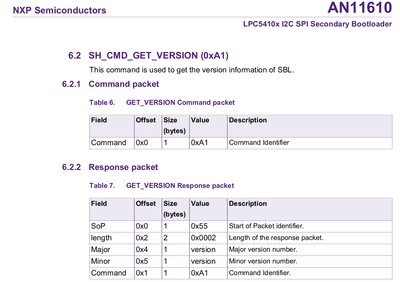

Then we followed one more document AN11610 for understanding the i2c communication for the steps 5-7 in AN12373 showing above.
From document AN11610 , We understood that slave addresses are 0x18, 0x30 and 0x1C.
The explanation for the 6th step Get version is shown below

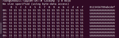

As per my understand I tried to write the 0x00 address offset to a value 0XA1. I choose the slave address as 0x18.
Later i passed the command i2cdump -y 0 0x18 for reading the registers, I got the output showing below
So, Please clarify that what i are the exact process happening while passing commands from 6-8 steps.
