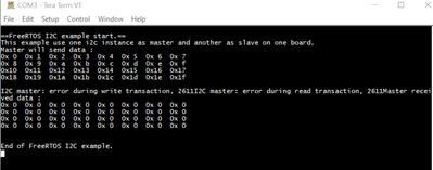

I have with me LPCXpresso5411x development board. I use MCUXpresso IDE to import a project sample freertos_i2c. It can build and run the debugger. However it seems there is no I2C communication establish, the callback i2c_slave_callback() is not triggered at all.
The following init is success:
status = I2C_RTOS_Init(&master_rtos_handle, EXAMPLE_I2C_MASTER, &masterConfig, sourceClock);
However the following attempt for master to transfer data fail with status 2611:
status = I2C_RTOS_Transfer(&master_rtos_handle, &masterXfer);
if (status != kStatus_Success)
PRINTF("I2C master: error during write transaction, %d", status);
I am expecting it works just out of the box, or is there anything I miss or should preconfigure before?

Hi misterbee,
There isn't any pre-configuration needed to run the i2c example. Could you please re-confirm both i2c connections?
I2C1 connected to I2C2
SCL P0_25(J1 pin1) --> P0_18(J1 pin11)
SDA P0_26(J1 pin3) --> P0_20(J1 pin13)
Can you also please confirm if you are connecting any extra boards or any other component? Did you modify the SDK example?
Best regards, Julian

misterbee
Just want to attach the snapshot of the error log from com port

misterbee
Thank you @Julián_AragónM , I can see the instruction now to setup connection I2C1 <-> I2C2.
Should I expect this setup already done when I download the sdk sample? Or I have to do this in addition?

misterbee
Hi @Julián_AragónM ,
It is now resolved, silly me, just realized need to do wiring to physically connect between the two I2C :D.
Thank you for showing me the instruction doc, otherwise I would not be aware of this :).
