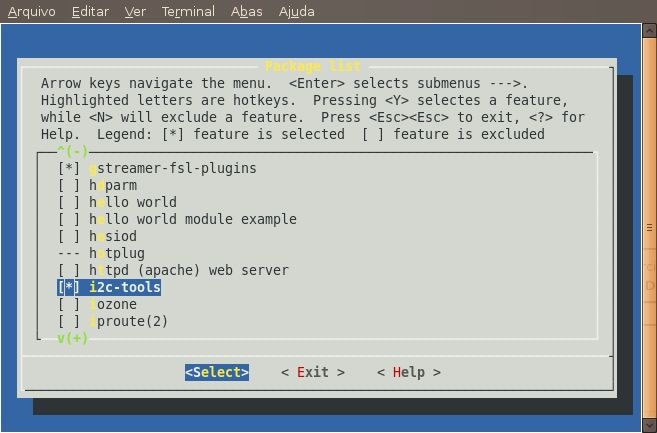

Enable I2C-tools in LTIB into Package List:
Reboot your file system, there are three new I²C commands: i2cdetect, i2cdump and i2cset.
All examples below were tested in a iMX27ADS, but this programs seems to have the same behavior to all platforms.
