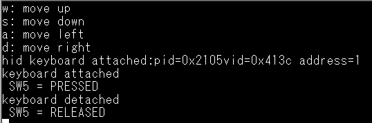

I am running keyboard2mouse example and trying to make use of SW5 (P1_1).
The example configures USB0  as host controller and USB1 as device controller; In which case P1_1 should be available for general GPIO use since USB1's over current functionality is only defined in host mode.
When I configure SW5 as GPIO, the MCU detaches the keyboard from the port as soon as I press SW5.
Why is that happening ? what am I missing? Please find test case attached; it uses FC9 for debug output. Please advise.

ZhangJennie
Hi.
Please share how to reproduce your issue with ordinal keyboard2mouse_bm demo code under SDK install.
Besides, Which IDE do you work with?

belmontbob59
Can you please shed some light on this problem ? I've attached a test case based on keyboard2mouse standalone version from SDK builder. What else do you need?

belmontbob59
I'm not sure I understand your question ? I've already provided you with the test case. I've downloaded the standalone project for keyboard2mouse  from NXP's SDK Dashboard and modified it to
-add support for SW5,
-switch debug output from FC0 to FC9.
This example uses KEIL IDE. Just connect a keyboard to USB0 and USB1 to host PC, wait for debug output to display "keyboard attached" and then press SW5.
