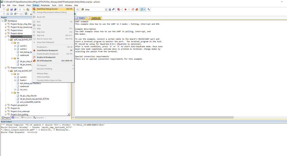

I'm using OM13098 (LPCXpresso54628) development kit with MCUXpresso IDE. I was having issues with this compiler, such as inconsistency, unstability, etc..
I also have a licensed Keil MDK V5.27 compiler. I also have some LPCXpresso54628 examples for Keil. I am able to compile the programs in Keil, and the output has extension .out.
How do I need to configure Keil in order to download the file to the OM13098 board directly? Do I need to output a different file extension?

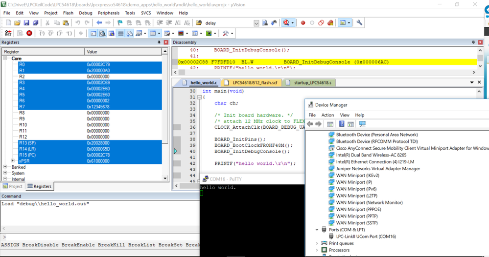

Hi, Viet,
As the following screenshot, if you set the COM port as COM16, baudrate as 115200, PuTTY tools can display hello world.

vn2000
Hi Xiangjun,
After I copied your files into /Keil_v5/ARM/Flash directory, I can compile and download the hello_world example. But I don't see the "hello world" output at the serial terminal.

vn2000
It's strange that it worked only after I do a 'Start/Stop Debug Session', not when I download the firmware into flash. But that's ok, I think this resolved my issue.

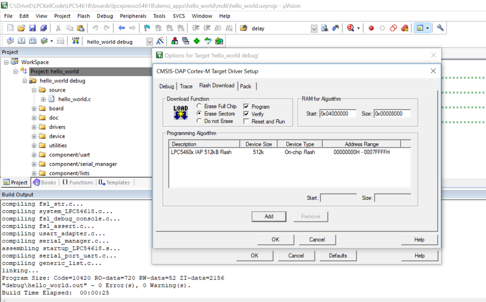

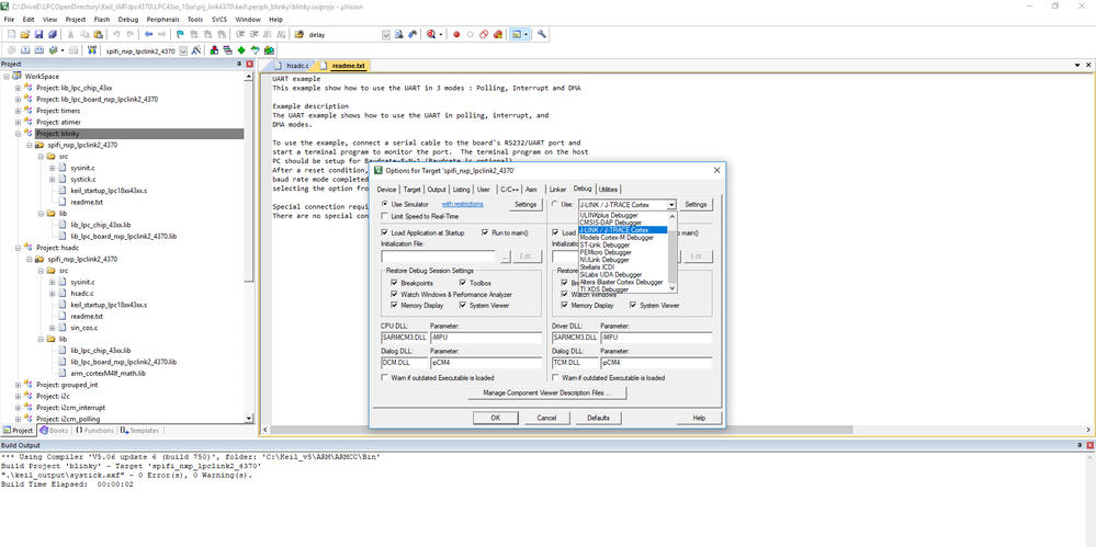

xiangjun_rong
Hi, Viet,
If you want to use the Keil to download the code to flash, you have to configure the device with which you download code for example J-Link, CMSIS-DAP Debugger..., on the Keil tools, pls click Flash->Configure Flash Tools, the Option for Traget... menu will appear as following:
You have to select the your device you are using by click Debug, even you have to click "Setting" in the the Option for Target menu to configure the device.pastedImage_1.png
after you select the device correctly, you can download the code by click Debug->Start/Stop Debug session as following:
Hope it can help you
XiangJun Rong

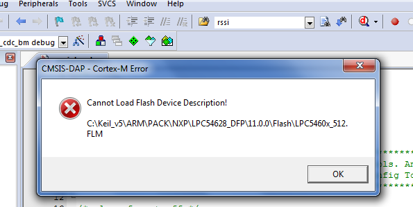

vn2000
Hello XiangJun Rong,
I found out the problem is that when I first plug in the OM13098, I see an LPC device in Device Manager in Windows. Only when I executed LPCXpresso IDE and go to a debug session, then the OM13098 changed to LPC-linkII UCom Port under 'Ports' in Device Manager. Then I have to get out of Debug mode. That's only when I can configure Keil the way you suggested. By that time I can configure in Keil as LPC-LINK2 CMSIS.
CMSIS-DAP is the only option that recognized OM13098. But when I go to 'Debug', 'Start/Stop Debug Session', then I see this error message:
In the Build Ouput of Keil, it says: Error: Flash Download failed  -  "Cortex-M4"
I am using USB Debug Link J8 Connector to the PC. I see  the user manual UM11035 Page 4 mentioning about Link2 Debug probe.
Do I need an external probe or can I use the same USB connector J8 as I used with MCUXpresso IDE?
Thanks.
5,477 Views

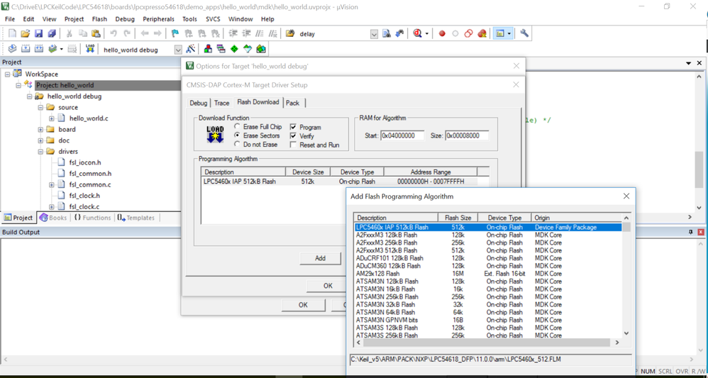

xiangjun_rong
Hi, Viet,
Regarding your question that the PC can not recognize the OM13098, I suppose that you close the JP5(DFU LINK) on the board, pls open the JP5 jumper.
Secondly, I suppose that the Keil can not find out the flash algorithms which leads to the error, pls refer to the following figure. If the programing Algorithms is blank, pls click the  Add software button to add the flash algorithms.
Xiangjun Rong

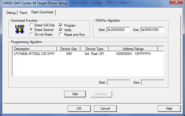

vn2000
Hi Xiangjun,
I added the flash algorithms as you said. But somehow the address shown is a little different from your example (10000000H instead of 00000000H).
With the address 10000000H, I see this error:
Load "debug\\hello_world.out"
No Algorithm found for: 00000000H - 00002D13H
Erase skipped!
When I changed the address to 00000000H, I see this error:
Insufficient RAM for Flash Algorithms !
Erase Failed!
I also noticed the Device Type in my environment says it Ext Flash SPI. In your dialog I see 'On-chip Flash'. The only logical choice for adding algorithm is LPC5460x.
Also, when I looked at the Keil_v5/ARM/Flash directory, here is what I see:
Here I only have one choice for LPC5460x_MT25QL128. So there is no LPC5460x_IAP as you have.
What do you think I should correct?
