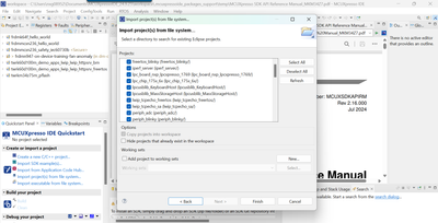

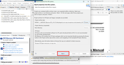

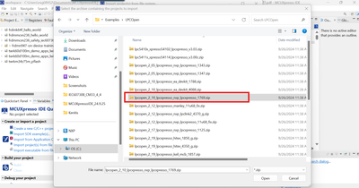

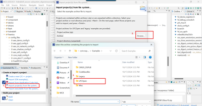

LPCOpen is already integrated in the MCUXpresso IDE. There is no need for additional downloads. All you need to do is:
1. Open MCUXpresso IDE, then open the project as shown in the figure below:
2. Select "lpcopen_2_10_lpcxpresso_nxp_lpcxpresso_1769.zip". and then click "open".
3. After the following interface appears, click "next".
4.Finally, when the following interface appears, it's what you need.
