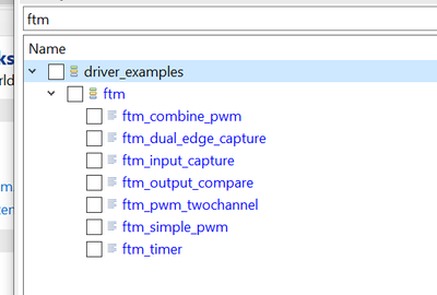

Hello @shoichi_kojima
Yes, FTM is not flexible as SCT.
You can describe your required function more detail, I'll help see if FTM can achievable.
Also there are some FTM demos under SDK, you can refer to:
Alice
