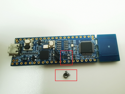

So I took the LPC845-BRK board to test (no peripheral devices attached and easy to measure at the JP1 jumper)

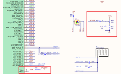

ZhangJennie
HI @DirkP
I found a BRK board and tested it. I can reproduce the problem. The current comsuption is on PIO0_07 pin and Vdda to Vssa through RV1. This additional comsuption could be at least 0.3mA.  To verify it, removing RV1 on this pin can reduce the current from 0.36mA to 42.5 uA on my side
Hope this will help you.

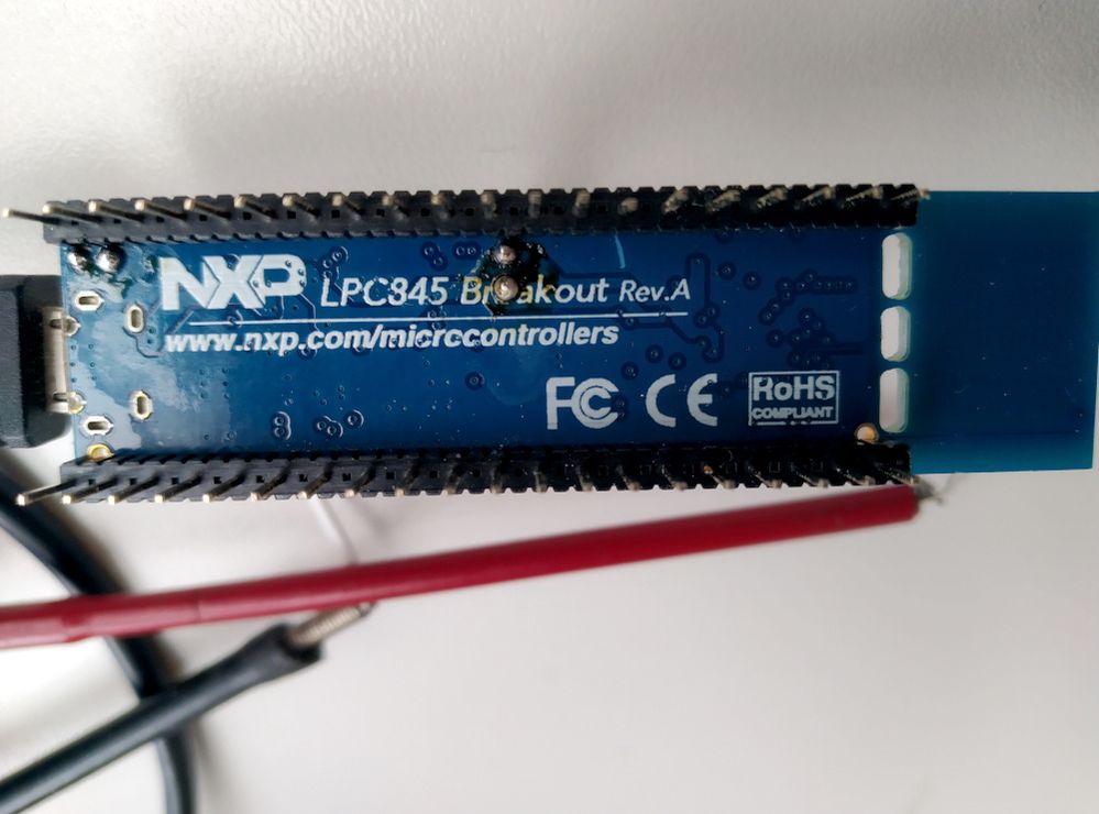

DirkP
Hi Jun,
I put all pins to input with pull-up (see attached source code).
Also used a wallplug socket (to USB 5Volt)  to be sure no connection was made to the programming/terminal socket.
As I expected, current dropped a bit (on account of the terminal socket) but not much:
The board itself is a regular breakout board from NXP:
As I said, I don't have connections to the GPIO pins, so how to measure ?
Dirk.

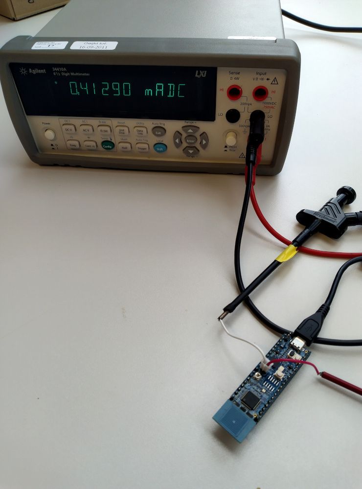

14,246件の閲覧回数
DirkP
Hi Jun,
Power comes from the usb but the measurepoints are on the chip itself so that shouldn't be a problem (see attachment).
Power is:
Regular  Operation: 7.04 mA
Sleep: 2.60 mA
Deep Sleep: 0.67 mA
Power Down: 0.46 mA
Deep Power Down: 0.32 mA
I must say, it will be difficult to investigate if you don't have the hardware itself.
It's just a standard breakout board tho.
Dirk.

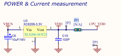

I checked manual. there is one point, please check if you are aware: A narrow
PCB trace connects the two holes for JP1, so this must be cut with a knife before installing
the header in order for an ammeter to be able to measure the current.
Have a nice day,
Jun Zhang

DirkP
Hello Jun,
Of course I cut this trace, otherwise I would measure no current at all
Dirk.
14,026件の閲覧回数
ZhangJennie
HI @DirkP
Jun Zhang
14,012件の閲覧回数
DirkP
Hi Jun,
You're quite right, somehow I overlooked this voltage divider.
Thanks for the help.
Dirk.
