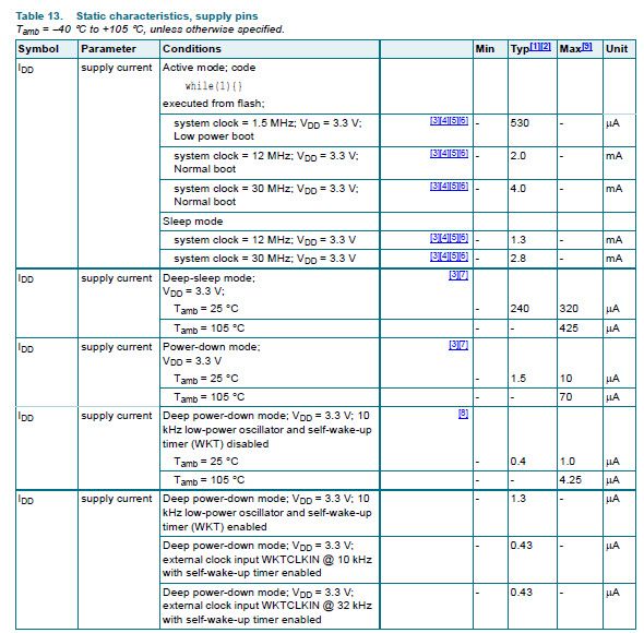

However, when customers take use of power_mode_switch_lpc demo to measure lower power static characteristics, they find discrepancies with data sheet. Take example with LPCXpresso845MAX board. In power down mode, the demo board current reaches to around 100uA in debug mode. But data sheet states the typical current value is 1.5uA, no more than 10uA (see the Table below). Where is the problem?
The purpose of the power_mode_switch_lpc demo is to demonstrate several low power modes and multiple wake-up methods to customers. We can’t get similar low power current value with default demo board as spec shows, but let's walk through a step-by-step demonstration and modify the routine to get the data sheet values.

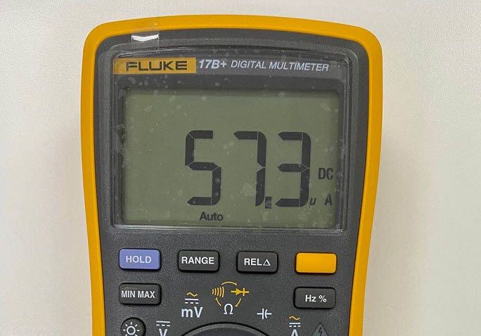

The modification is to turn off BOD power domain and watchdog clock in power down mode, compile and download the code again and enter the power down mode. At this time, the measured Idd is 57.3uA
In this way, Idd is significantly reduced. However, 57.3uA is still far from the typical value of 1.5uA stated in the data sheet. This is due to MCU debug power domain is turned on by IDE debugger, which leads to extra current consumption.
 3. Thus we disconnect debugger and let the development board work in stand-alone mode (power off and re-power on). After power on, LPC is in power down mode. At this time, the measured Idd is 1.4uA. This is quite similar as the current value in datasheet.
